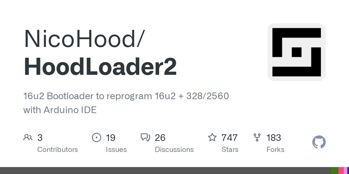

You can learn about the most common way to do it with an Uno here:
Note this only works with the official Arduino Uno or the clones with the ATmega16U2 USB adapter chip. You can't do it with the cheap derivative boards that use the CH340 USB chip.
The best way to do it is to buy an Arduino board that already has the keyboard emulation capability you need. The Uno is simply not the right choice for your project. Although it may be technically possible to do it with the Uno, it will be a very advanced process. With one of the Arduino boards that have native USB capability, it is much easier.
The Arduino Leonardo, Arduino Micro, and Pro Micro are all excellent choices for this project. You also can use one of the more advanced boards like the MKR Zero or Nano 33 IoT, but you might find these a little bit more challenging.

That chip does not have native USB capabilities. It is theoretically possible to do "bit banged" USB emulation on it, but that will be very challenging and likely unreliable.
Of more interest ist that little square chip next to the USB socket. That is the ATmega16U2 microcontroller. This chip does have native USB capabilities. So it is easier to use that chip to emulate a keyboard. You can learn how to do that at the link I provided in my last reply.
Yes.
Correct. You need to upload some special firmware to the ATmega16U2 microcontroller. The normal one the Uno comes with is only capable of creating a serial port.
You might get your Uno into a state where you can no longer upload sketches to it. It could always be recovered with enough effort, but you might find it to be a very difficult process.
I don't understand the question. What do you mean by "secure"?
I meant that if I change the mode, could I return the device to the original state?
It's unlikely you would get it into a state where it is impossible to recover back to its original state. However, you might get it into a state where it is difficult to recover it back to its original state.
For example, you might find that you are unable to use the DFU programming method like you see in the Atmel Flip tutorials and instead need to use an ISP programmer connected to the ATmega16U2's ICSP header in order to flash the original firmware to it.
