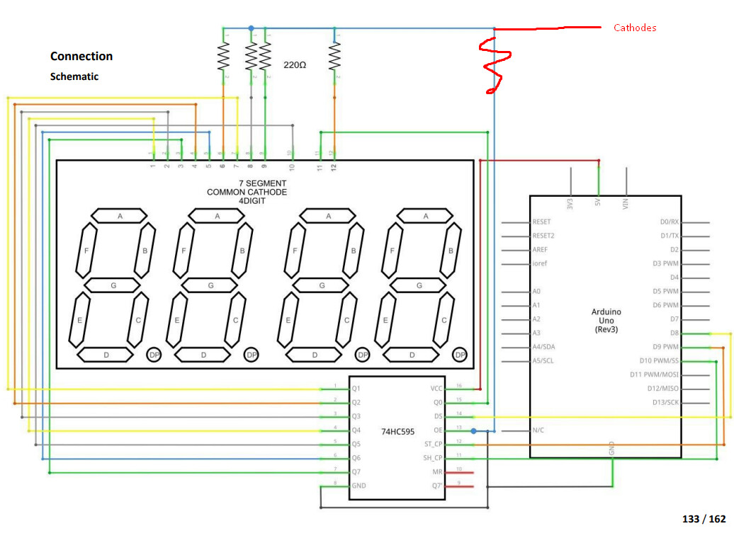

Making stopwatch with 595 and 4 digit display
I am trying to make a stop watch that displays minutes and seconds, and after reaching 59,59, I want it to display hours and minutes. Then it also has a start and reset button. The set button starts the time, and if you press it again you pause the time, and if you press the reset button it resets the time. I have also attached LED's that will light up when certain hours are crossed. The issue I am having is that the display isn't displaying fast enough, it is flickering even though the delay I set for the screen is small enough, I have a common cathode 4 digit 7 segment display.
Connections:
Arduino 8, 9, 10 to 595 14, 12, 11 respectively.
595 1, 2, 3, 4, 5, 6, 7, 15 to display B, C, D, E, F, G, DP, A
595 8 goes to 595 13, which is connected to ground
The Cathodes are connected to 13,12,11, and 6 in the arduino through a resistor.
And my LED's are connected to 2, 3, 4 on the arduino.
My buttons start and reset are connected to 7 and 5 respectively.
Here is an image of what it looks like without the buttons and LED's
