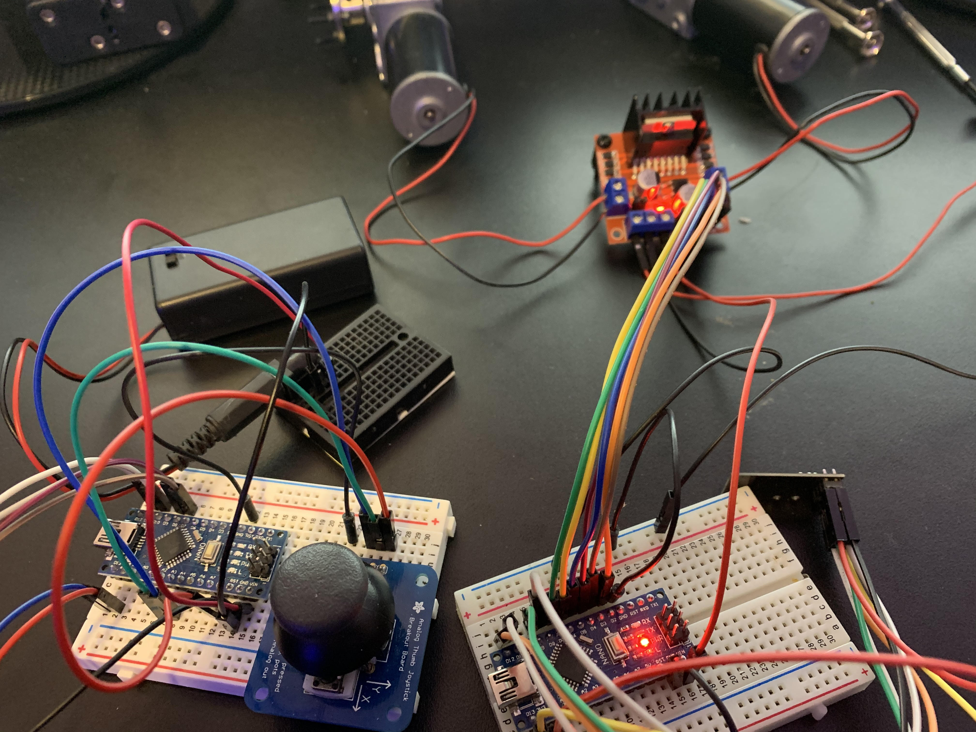

I have found a sketch online that I am trying to change for my needs. Unfortunately I am stuck in a situation which I need help.
The idea is 1 joystick to move wirelessly a small tank vehicle. I am able to have motors A&B go forward when X is pushed forward and motors going backward when joystick is pushed backward.
I have tried to add extra lines to have motor A go forward and motor B go backward when joystick is pushed left and have reverse action done when pushed right but I seem to not be able to do so accurately.
What I am doing wrong?
Thank You

Fabiolus:
What does "have reverse action done" mean?
In your Right and Left routines shouldn't you be reading something into motorSpeedA and B BEFORE you start adding and subtracting values from them?
Steve
Steve,
Sorry for the confusion.
"have reverse action done". I meant that I wanted the below behavior.
Joystick pushed forward = both motors going forward.
Joystick pushed backward = both motors going backward.
joystick pushed left = left motor going forward and right motor going backward
joystick pushed right = left motor going backward and right motor going forward.
I will look into your advice, I have been stuck on this for a while :frowning:
thank you
Good day,
I took a different approach and have somewhat better result even though it would had been cool using the other method
In the end it turned out I had to be careful when troubleshooting, I launched serial monitor to see pot values and behavior and noticed that I did a mistake in the pot value for left/right.
Now the results are great, maybe I will tweak better the map() for the joystick for better response. I am learning more and more.
Thank You
Thank You

Or you could do this:
leftmotor = lX + lY - 90;
rightmotor = lX - lY + 90;
lX and lY are the x and y axis if the joystick. The value my joystick outputs is 0 to 180. If your joystick output is different, you need to change the value of 90 to half the value of your joystick, if that makes any sense :slight_smile:
