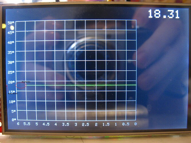

Mapping temperature to a graph on a TFT LCD screen
@6v6gt
This is the code for drawing a graph, only I have absolutely NO idea how to map the temperature readings from a DS18B20 onto this graph. I only want to draw the temperature reading every 30 minutes.

Does anyone know how to do this? I haven't been able to find any working code for doing this with this sensor.
Thanks in advance!

The complete code is as follows:

I realise that, but how do you turn it into that?? And no, there is no example of what I want in the library. Absolutely none whatsoever. I have checked every single example already.
You see all those setCursor() statements? They're plotting the grid. It looks like the legends are in %. So scale your data as %. Then the formula is:
y = ymin + (datum% * (ymax - ymin) / 100);
ymax-ymin is the number of pixels vertically in the plotting area. The datum is in percent, hence the 100 divisor. You iterate thru x. Look at the setCursor() statements.
@madmark2150
That's the info I've figured out.
ymin = 33;
ymax = 293;
y = ymin + (datum % * (ymax - ymin) / 100);
What is
datum%
and how do I tell my arduino what that is?
What do you mean by
That's true for part of it, the other part is degrees celcius.
Sorry, but I've never done this sort of thing before, so I need everything explained.
Here's the new code:

@madmark2150
Where do I define ymin, ymax, y?
@madmark2150
This code works:

When I change the proDebug to 1 as in the above code, my Serial monitor returns this:
-30412
-30410
0
2
3
5
7
8
10
11
13
15
16
18
20
21
23
25
26
28
30
31
I think this is the time??
But what is the -30412, -30410??
The main question I have is where do I set where the first point is drawn?
    // draw point
    tft.fillRect((mark[valuePos] - 2), (locationBlock[valuePos] - 1), markSize, markSize, pointColor);
    // map the value - current point
    locationBlock[valuePos] = map(temp, 0, graphRange, originY, (originY - sizeY));
    // draw point - current point
    tft.fillRect((mark[7]), (locationBlock[valuePos] - 1), markSize, markSize, pointColor);
    // draw all points
    for (int i = 0; i < 8; i++)
      tft.fillRect((mark[(blockPos - (i + 1))] - 1), (locationBlock[(valuePos - i)] - 1), markSize, markSize, pointColor);
From what I can work out, I think this is where it decides the place to draw the points (in void graph()), but I don't know where to edit it to choose where on the X plane I draw it.
@Nick_Pyner @Paul_KD7HB @madmark2150

It now looks like this:
But there is a strange red dot and a missing green line:
