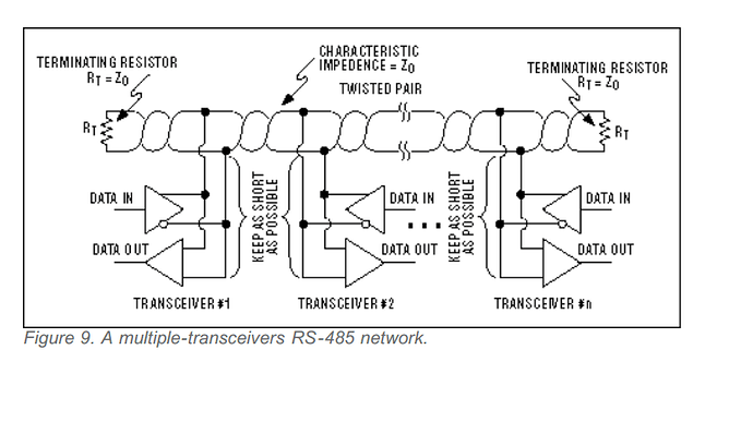

Add a RS485 transceiver to each device.
See Figure 9 of attached.

Yeah, one more friend of mine also suggested to go far rs-485 setup, but he doesn't knows much about it, where should I connect twisted pair wires?, what is data-in and data-out, before you could answer this, I will explain my system in detail.
I have LM35 temp sensor, values are read by Arduino Uno( AnalogRead) by doing some calculation I display the temperature in 16 x 2 lcd display, which is enclosed in some case powered by 12v 1 amp adapter fixed in wall. I have around 12 temperature meter like this. Now where should the DATA IN and DATA OUT in rs485 should go in Arduino, and to what pin does the twisted pair cable connects.?
I have attached the pic which you referred to. Adding to this I need to see the data in my pc.
