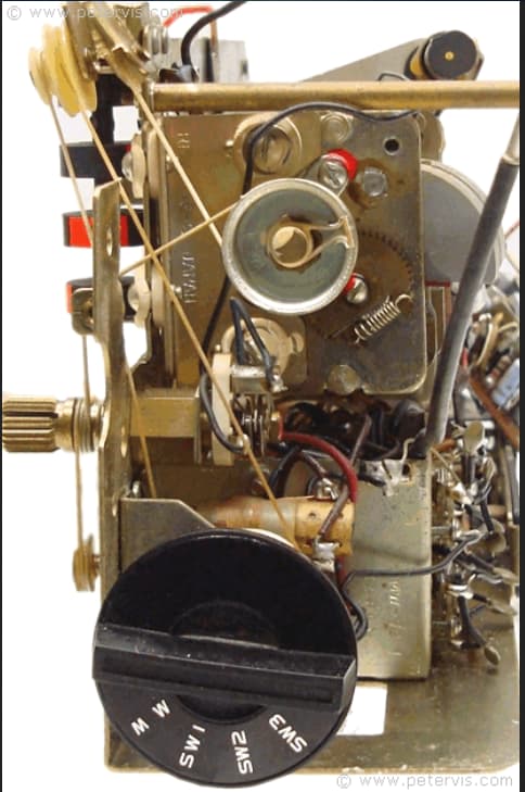

Wrap a strong, waxed thread several times around the driven shaft, and use it as a belt to drive an encoder or indicator. As done in old-time radio tuners.
Fancy example (tuning knob shaft at left edge):
That's a great idea. I could fix a gear around the manual shaft that turns a small gear driven shaft that the encoder mounts to. Making this fit inside of 4" diameter area would be great.

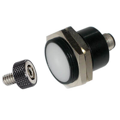

There do exist non-contact magnetic shaft encoders. Examples:
