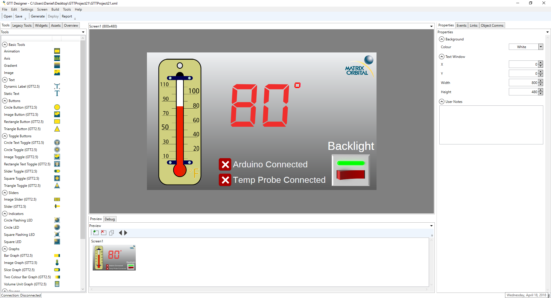

Step 1: Designing the User Interface
The GTT Designer Suite allows users to easily drag and drop widgets on screen. Images and font files can also be imported for use when creating GUI's. For this project, we've dragged in a Bar graph, 3 Image Toggles, a label, and a Thermometer image. The Bar graph is used to visually represent the current temperature. The label displays the current temperature value numerically. Two of the image toggles are used to indicate whether or not the Arduino and DS18S20 temperature sensor are connected and operating properly. Finally, the third image toggle allows users to turn the display's backlight on and off.
You can download our GUI design here.
You can download our free and fast GUI design software here.
Once the design is completed, the project can be deployed to the GTT. You'll need to connect your PC to the GTT's Mass Storage header, and hit "Deploy" in the GTT Designer. All the necessary files will be generated and deployed directly to the display.
