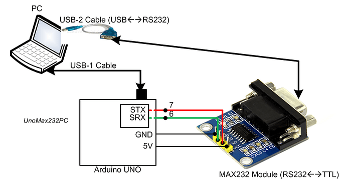

1. Make the following setup (Fig-1):
Figure-1:
2. Do not connect USB-2 cable with PC. Connect only the USB-1 cable.
3. From start menu, open an IDE; be sure that correct COM port has been assigned for UBS-1 cable. After that Upload the sketch of your post #1. Open the Serial Monitor-1 at Bd = 2400.
4. Connect USB-2 cable.
5. From start menu, open a second IDE; be sure that correct COM port has been assigned for USB-2 cable. After that open the Serial Monitor-2 at Bd = 2400. Choose Carriage return option for Line ending box of Serial Monitor-2 (Fig-2).
Figure-2:
6. Enter Hello in the InputBox of Serial Monitor-2 and click on the Send Button.
7. Check that Hello has appeared on the OutputBox of Serial Monitor-1.
8. If the above steps work, then it is fine; else, wait to receive help once I return home from my works.
Good luck!

it's difficult to see, but change the connection to
Pin 6 --> TX on the board and
Pin 7 --> RX on the board
what happens?
Thank you i am able to see the response but data is shown as numbers... is it becos of ASCII code conversion ?
