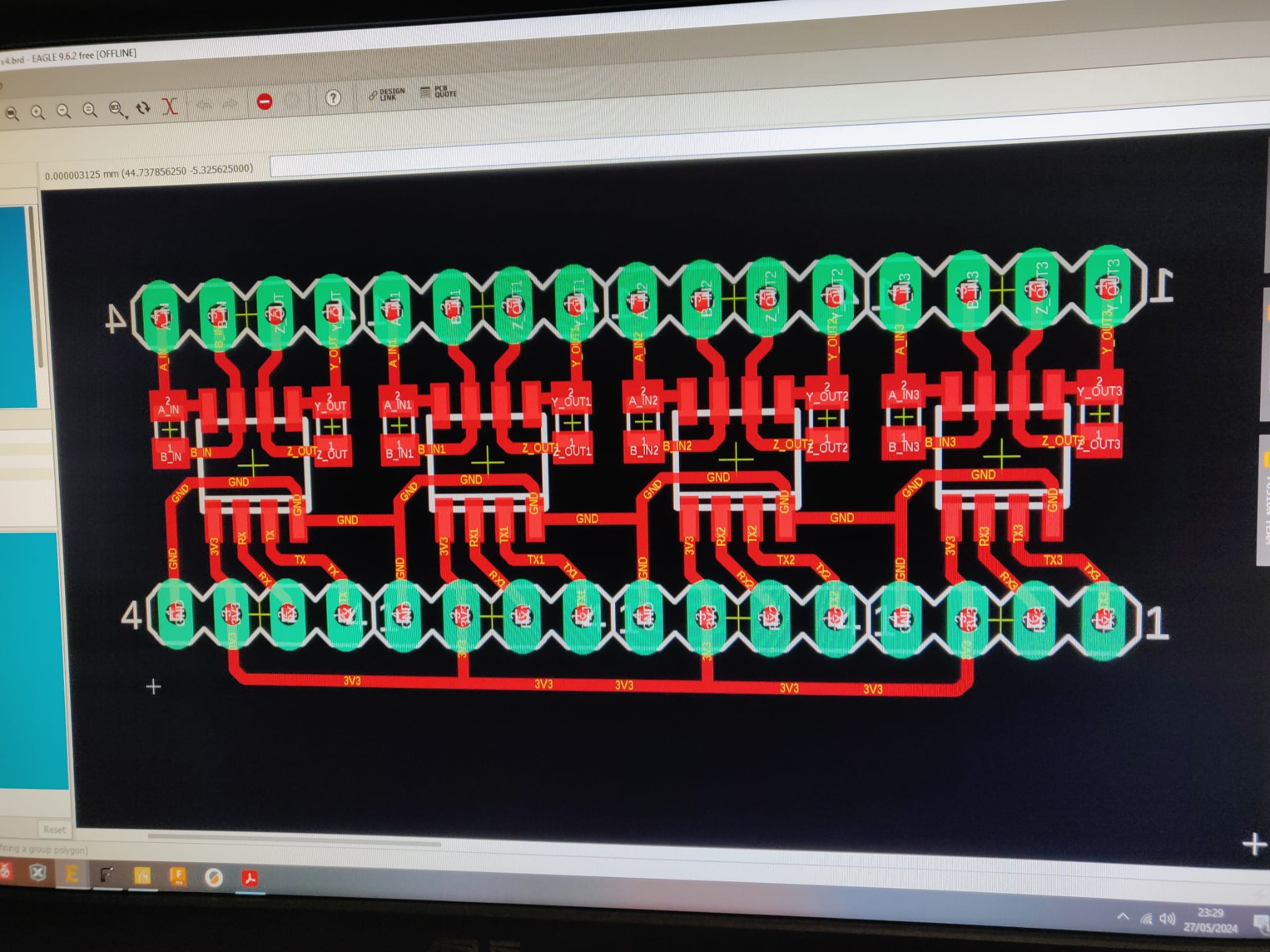

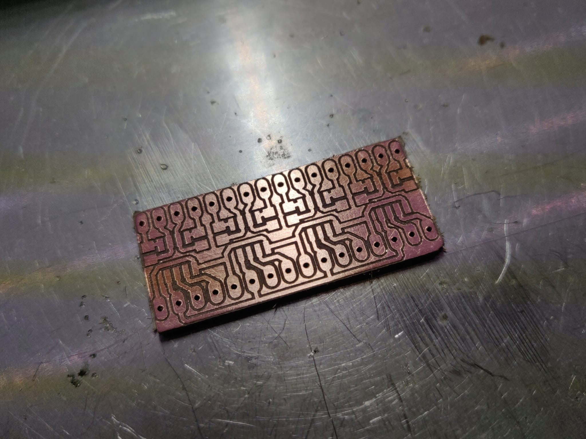

i'll divide the network in 4 single ended lines to avoid buying different chips when i have a hundred of these lying around.
on the master simply wire 4 parallel MAX3490 with 3V3, GND and TX in common, while RX is to be wired to 4 different inputs, and just switch the RX pin to whatever node i'm waiting to respond... (because i think that even the RO is totem pole and shorting it with other chips will create conflicts)
how? i'm using PIC24EP256MC204 on the master... it has remappable pins, just chose 4 different pins and remap the RX to the pin wired to the RO of the line i want... so i dont actually have to remake any board from scratch... just a small RS485 splitter board with pin headers, 4 MAX3490 and 4 resistors
PRO:
-i'll make it today in 2 hours max
-hey... it's free
-no waste boards
CONS:
-more cables since each slave has it's own personal cable, but then again... i have recycled ethernet cables laying around (taken out after a restoration)
-less expandable since splitter has 4 chips and that's it, plus i would need to put even more cables, and i dont think there is any more space in the tubes
