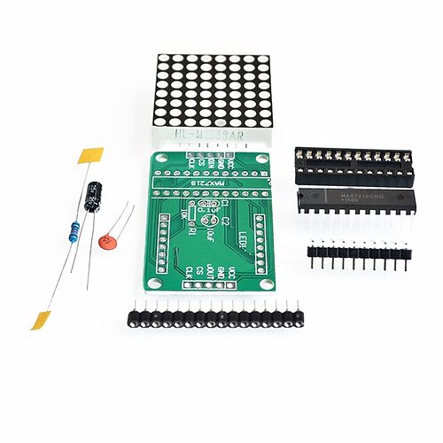

The module in your picture appears to be the version with the LED matrices soldered rather than socketed and does not have the inter-module connections on the PCB, thus the pin headers and jumpers. One advantage however is that it is fitted with straight pins on the ends so you can chain that to another similar module using jumpers.
Those with the right angle pins on the ends are a major problem, the absolute worst being when the matrices are soldered directly. If they are socketed, at least you can remove them and de-solder the offending right angle pins.

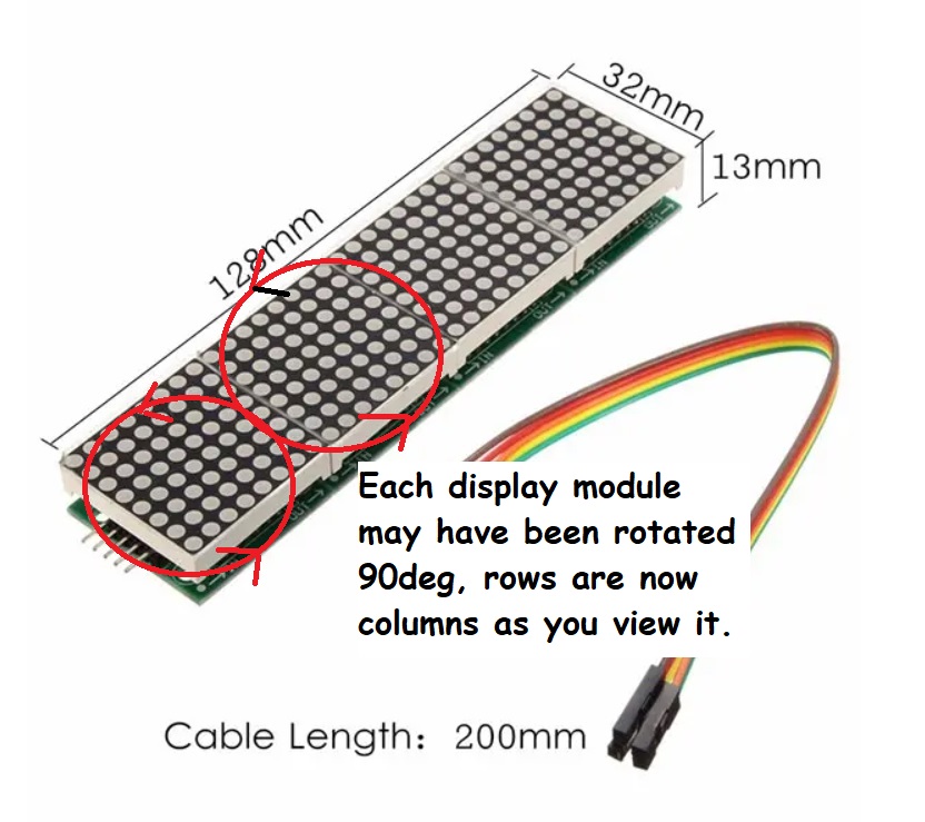

I think the LED MATRIX is turned 90deg buy having headers top and bottom.
I am confused. To which modules are you referring?
Tom.... :grinning: :+1: :coffee: :australia:
Sorry, but I do not see what it is you are comparing to what and how you may be suggesting the modules could actually be rotated in a four module PCB.
This is the FC-16 design. The headers are top and bottom as the control pins are on the sides in order to chain the modules. It would be very impractical to do otherwise.
Certainly the "old" module is the other way around, rotated by 90°, I would have to look up what its designation is for Marco's code as yes, the connections may be somewhat different and since it uses the same 1088AS matrix, Marco's code has to operate quite differently, swapping rows and columns.
There is one minor variant designed for two dimensional stacking, but I presume it actually follows the "FC-16 design:

OK, got it! :sunglasses:
This display is not a FC-16. :astonished:
At least, it is not exactly an FC-16. Its connections are the same except that the matrix is rotated 180°. This is consistent with the original description (#1).
I am not sure whether the solution is to use
#define HARDWARE_TYPE MD_MAX72XX::ICSTATION_HW
which I suspect is wrong as I cannot reconcile the connections on the ICstation module, or to continue with the "FC-16 " declaration in the code, but to add
#define HW_REV_ROWS 1
#define HW_REV_COLS 1
I suggest you try these two options, unless Marco can clarify this further. :grin:
