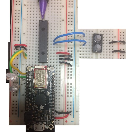

MCP23017 library interrupt code not working
I'm trying to get the MCP23017 adafruit library interrupt code to work. I took the code in the library and changed the interrupt pin to pin 1 and changed the part where it flashes to turn 1 of two leds on instead of flashing. Thank you for any help in advance.
Here is the code

Attached is a picture of my setup.
Which Arduino has an external interrupt on pin 1?
Generally, it is not a good idea to use Arduino pin 1 (or pin 0 ) if you are also doing serial operations like Serial.print.
You appear to be using a 32U4 and Interrupt #3 is on pin 1, not interrupt #1 as you have in your code.
use this format for attachInterrupt() to avoid confusion :
attachInterrupt(digitalPinToInterrupt(pin), ISR, mode);
See attachInterrupt() - Arduino Reference
On a 32U4 based board, Serial methods don't involve pin 0 and pin 1. Serial1 methods do, though :wink:
Thank you for your responses.So I fixed one issue but still have another to fix. I took this answer.
6v6gt:
And that was the issue I updated the code and the buttons turn the led on and off. The problem is I don't know where to put my project code. I tried sticking a function at line 102 like this to run my code instead of the sleep mode and it didn't work.
 while(!awakenByInterrupt){myproject();}
I also tried to to change line 99 to this like it was suggested above and it broke the code
 attachInterrupt(digitalPinToInterrupt(arduinoInterrupt),intCallBack,FALLING);

What will run constantly is displaying data to a display and I want the interrupt to see button pushes and change menus. I just need to know where to put my project code so that the interrupt keeps working. I understand what the code is doing somewhat and tried to change it around and ended up not making anything working. Thank you again in advance for the help.
