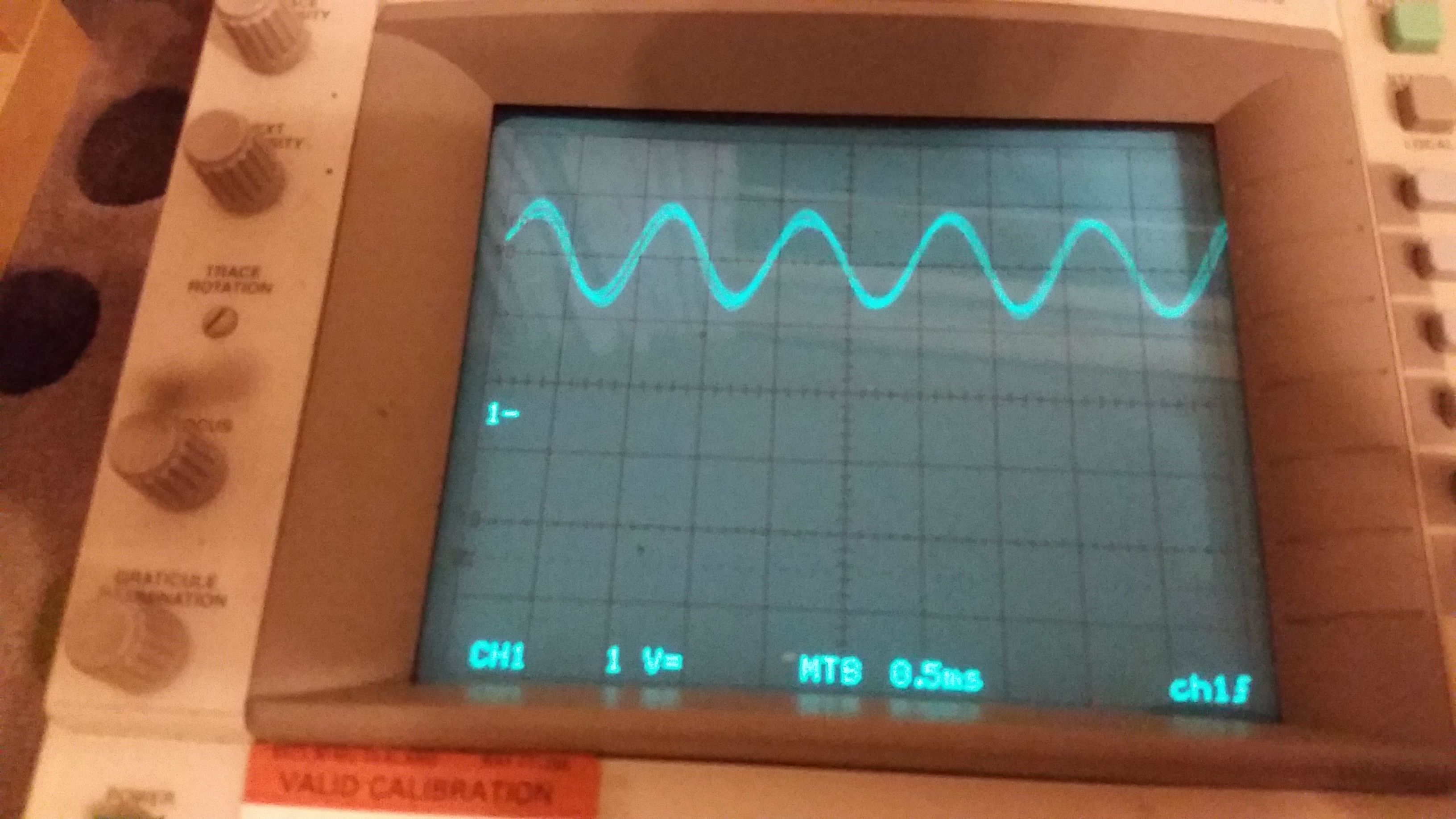

Hi there,
I'm trying to develop exactly the same device - I work in the cinema industry.
I need some help from the hardware point of view though. My electronic skills are scarce and I am unable to design this on my own.
I have acquired a photodiode and I have an output but the sensitivity of the diode seems to be quite high and I have to feed it very little light to see something which is not 1023 on the analogue input! Maybe that would be ok for a low level light source as the one you can find in a cinema room - 48 candelas on screen - but I was wondering if there was a way to change the sensitivity by turning a trimmer or so.
Sound-wise is the same issue. I have purchased a ready-made sensor on the internet but it doesn't seem to do what I want. The mike output only reaches roughly +/- 20mV when some pink noise is played.
Once I have the inputs sorted and I can see what I want with my oscilloscope, then I'll work on the code.
Anybody can help me?
Thanks
Tony

Need more details. Your circuit, code and the make/model/code of the photodiode you have.
Hi Johnny,
Thanks for your help. For now I have purchased a couple of pre-made modules from adafruit. They seem to work - the light sensor does not 'clip' anymore, we'll see if that's enough for a 48 candelas flash.

I have made some progress. I've purchased an Adafruit microphone preamplifier and a light sensor. I have also purchased an LCD display.
The code works and I have been playing with it with cool results - please bear in mind this is my first Arduino project!
I believe my hardware problem lies in the microphone. It does not seem to be sensitive enough to give a good separation between noise floor and the "beep".
I have written a quick code to display the max value read by the sensors. The microphone feeds 555 with no sound (the trimmer on the back of the board is set to maximum). Checking with my oscilloscope the board seems to introduce about 2V bias when the trimmer is set to maximum.
That said the BEEP is clearly read at 2V p/p on the oscilloscope. But the analog pin reads a value between 650 and 700. I feel this may be too close to the noise floor (mostly caused by the bias) to give a precise reading.
When testing, I have 74ms most of the time (sound is indeed out of sync) but I also have other values (89,100, 120) too many times. I feel the signal coming from the sensors is not large enough to provide a reliable reading.
I am not too concerned by the light sensor for now. How can I improve the microphone?
