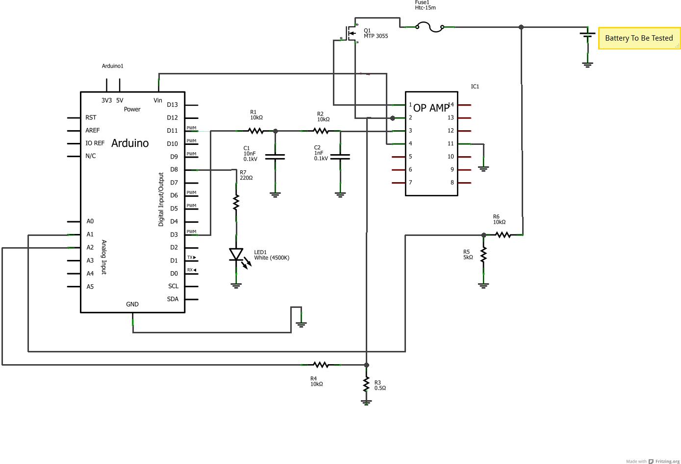

I need to measure 12v from a battery, i am using a voltage divider of 10k and 5k, so 4v=12v
the data collected is something like this when using default arduino reference (5v)
Two problems, first that there is too much variation in the voltages read, how can this be corrected

and other is that if i multiply it with factor of 3 the voltage i get is like this

which is significantly lower when measured with a meter, meter dont give a reading less than 11V !!

Vout = Vin * 5K/(5K+10K) = Vin * 0.3333
Perhaps your resistors are off? Put a meter on them see if actually 5K and 10K. The 12V too, see if actually 12V.
Resistor values are correct with ~1% error !
Battery voltage using multimeter is around 11.18Volts
This is giving a different value !
But you said you only had 11.18 going in.
So Vout = 3.73V.
Analog read should be 3.73 / (5/1023) = 763.
Then 763*5/1023 = 3.729
Is your 5v sources to the Arduino really 5V? That would throw the results off also.
The source Voltage might be less as i am powering it through USB
What if i am drawing current from battery and battery voltage is dropping constantly ?

Measure your USB.
If you don't have 5V then this equation will be off:
float voltage = 5*voltsense/1024;
Also it should be 1023. 0b11 1111 1111 = 1023 which is the max reading you can get.
Attached is the data collected, there is too much fluctuation in the readings.

I agree with CR. The real issue is that you are using nominal values for all of your assumptions, which isn't the case. Small errors in the resistors (you didn't say what the actual measured value was), battery voltage, and VCC supply will result in your calculation being off.
Also, make sure you are using the correct data types for variables and constants.
  float voltsense = analogRead(voltpin);
None of those are floats.
int voltsense = analogRead(voltpin);
float voltage = 5.0 * voltsense / 1024.0;

Its a controlled current sink with battery voltage measurement (attached diagram), where i am taking readings 1 second apart and storing them in MicroSD Card !
The 10k resistor reads 9.96k on meter and 5k reads 5.01k
The battery Now Reads 11.12V through Meter & Voltage After the Voltage divider is 3.76V
But my code should be independent of voltage reduction, as i need to monitor battery as it discharges but it should be able to measure and scale from 12 to 1 Volt !

And what does the 5 volt supply read?
5.00 to be precise but thats through the external 5v pin provided on arduino i believe the arduino default internal reference might be lower ?
simplytuff:
Why do you believe that?
Just do the ratios so they agree with reality. It should be fine.
