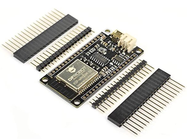

Hi ardutimo,
It is possible to measure the battery voltage on an Arduino Nano 33 IoT using a resistor potential diver as stated by MartinL above, connected to the Nano 33 IoT's analog inputs.
However, the Nano 33 IoT really isn't suitable for a battery-powered environment because it has
very limited sleep capabilities & consumes way too much power when it's just sitting there doing nothing! It would be far better for you to use an ESP32 which has very good sleep capabilities in a battery-powered environment.
For example, I have a setup using an ESP32 that wakes up every 600 seconds & collects - Temperature, Humidity, Pressures, and Sea level pressure including battery Voltage & calculating the battery % left. It then sends all this collected data to the Arduino cloud, it also some of that data out via an nRF24L01 radio, then it goes back to sleep for 600 seconds. I'm powering this from a high capacity 13400mAh lithium-ion battery pack plugged straight onto the ESP 32 I'm getting well over a month between chages. :slightly_smiling_face: Although I don't use the ESP 32 inbuilt battery charger like this is only a 500mAh charge rate & takes forever to charge a 13400mAh battery pack.
The ESP32 I'm using that is supported by the Arduino IoT cloud & has battery connection capabilities including an inbuilt resistor potential diver already connected to an analog port is THIS one.
HTH?
Hi @robrs
This is an extremely interesting proposal :slight_smile: it does seem like a much better alternative. The main reason I was looking into the Nano 33 IoT was the price/value/size ratio, but the FireBeetle ticks all the boxes but one - is there something similar with headers? I'd like to avoid soldering if possible. Or if you're able to reference some other alternatives I'd be very grateful. I did try to Google it (best board to use etc), but it seemed like the information is quite scant or my google-fu is not that strong :slight_smile:
Hi ardutimo,
The FireBeetle is supplied with the following headers -
You would just need to solder the pin header on. If you are not confident in soldering the pin header in place, is there a mate you could ask to help with this?

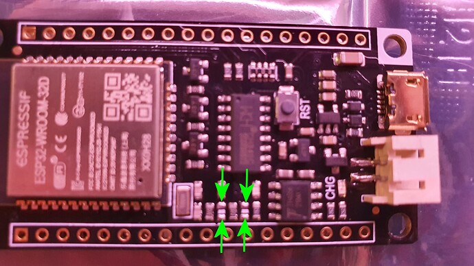

Oh yes, one other thing to note with the ESP 32 FireBeetle is they did not fit a couple of 0-ohm resistor links to enable the Battery monitoring via Analog port 0 !!
The photo below shows where a couple of solder links need to be added between the green arrows -
HTH?

2. The inbuilt potential resistor divider on the ESP32 will only measure (When the links have been inserted as previously shown) the battery voltage of a battery connected to the JST-PH connector NOT the USB connector. You would have to set up an external potential resistor divider, not insert the links previously shown & connect the output of the external potential resistor divider to A0.
See the first page of the ESP 32 FireBeetle Schematic & you'll see the inbuilt potential resistor divider connected to VB, GND & A0 You will also that the USB 5V is not monitored!
