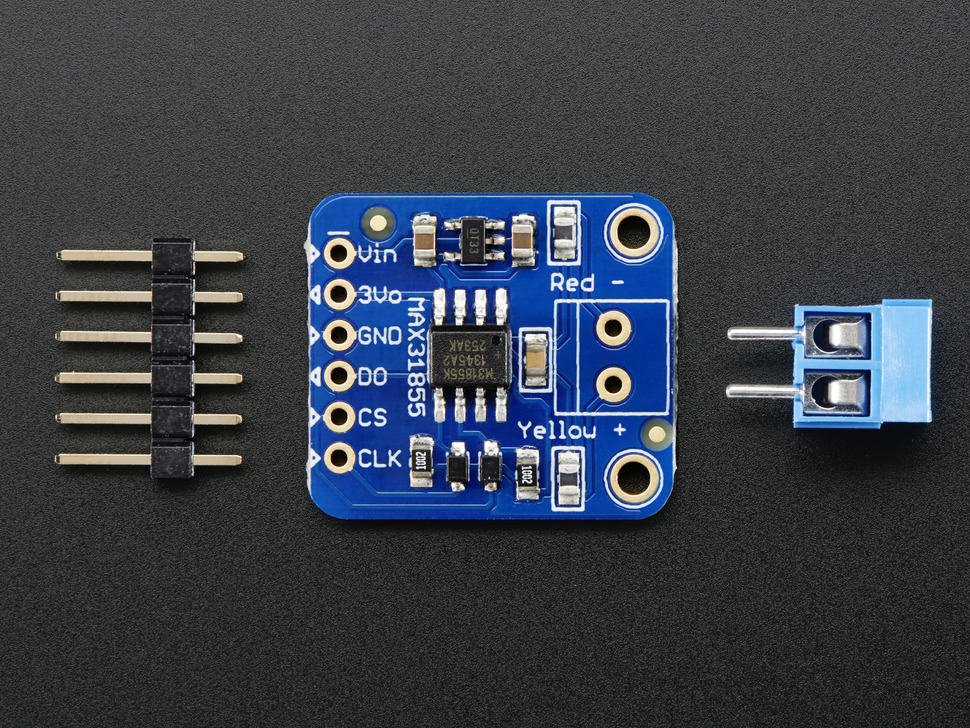

Hey Guys,
so I have an Application where I want to measure temperatures roughly between room temperature and 500°C at two different points. I have searched the Internet which recommended Type K Thermocouples.
So I went ahead and bought 2 and for each a Max31855 Controller.
Now the issue is getting both to run at the same time.
Right now my setup consists of a Breadboard, 2x max31855, 2x thermocouple type k, a Arduino uno and a 1602 LCD Keypad Shield plugged into the Arduino (all the Pins are soldered into the Shield).
I am running the Sensors via 3.3V, which they both get from the Arduino (and GND back).
Over the Breadboard I am connecting the thermocouples to 5 Pins of the Arduino.

This is basically the Adafruit Code, but changed so that its actually using 2 Thermocouples.
If I run this Code, one thermocouple often throws error codes (when not, it will actually give the correct temperature). The Second Termocouple only measures 0°C.
Keep in mind, the Thermocouples are not connected to anything, they are just loosely laying on the ground.
If I disconnect the Power supply of one Thermocouple controller, the Measurements seem to work, but also very unreliably
Does anyone know what is going on? I have no clue why one is reading fine (well not even that) and the other is not working at all?
BTW. If anyone can suggest any other ways/sensors to measure these high temperatures, id be open to anything.
TL;DR: I cannot get 2 thermocouples to work
Is there any difference if you use different CLK pins for each MAX31855K?
No
The only thing I noticed is that the 5v/3.3V has a big influence on it. Basically, the thermocouple will only read values if its plugged straight into the arduino (either direct or over the 1602 Shield, doesnt matter).
The Layout/which Pin I use for CLK/CS/DO doesnt matter really ( I have found).
But if I plug the 5v into the breadboard and the 5v from the Arduino into the Breadboard, the Sensor wont read anything (0°C)
This isn't clear. What exactly is the first "5v"? The sensor VCC pin?
Same for the second "5v". Is that the 5V output pin of the Arduino?
This datasheet says to use 3.3V for the sensor VCC. The signal levels are also directly related to that.
The Arduino UNO is a 5V device, so you'll need some signal level shifter.
For a type K thermocouple you should use the MAX31855K version.
Also, don't skip the capacitor between VCC and GND.
Try to get just one of the sensors to work reliably, then you can add the second.
To start out, I have to say that I managed to get the Setup to run. This is definetely far from optimal (or even usable right now but I might have to figure something out) but if I use an Independent Power Pin for each Sensor (I also have to power a Relay so its not easy) it actually works.
So now I am using:
VIN -> Thermocouple 1
5V -> Thermocouple 2
3.3V -> Relay (its actually a 5v relay but it seems to work, the status lights are just a bit dimmer).
The first Time I ran this, everything seemed to work perfectly. No Error Measurements, the relay worked, everything was fine.
In the Meantime, I have found out that its actually a terrible Idea to use the VIN Pin. It seems like the Max31855 which was plugged into it has died because of overvoltage (there is a noticeable swelling on a Chip and the Device has started to smell terribly).
I am unsure why, or if this was the only cause of its death as I started to power the Arduino with the USB over my laptop (which is always 5v right?). The second time I ran it, there were constant error Messages in both thermocouples. I thought, maybe the Arduino doesnt have enough Power and I plugged into my Arduino Power Supply (9V). I am guessing that the VIN Output will Output whatever Voltage it uses to power the Arduino. So the Arduino switched to 9V, which seemed to be a bit too much for the MAX31855.
Can I even use the VIN for Power Output long term? Would it work if I only use a 5v Power Suply?
I have a 5V transformer which I want to actually use to power everything, but the Sensors dont want to read anything unless they are powered directly by the Arduino. Because I just tried it out and the Transformer will actually power the relay, but if I plug the Sensors into it, the Sensor will just read 0 (I just tried one for now since the other one is dead).
Sorry, the first 5v is the VCC from the first max31855, the second 5v is the Arduino Output.
hmmmmmm
I am unsure about your Datasheet. I have thought about the possibility of the Voltage being wrong (see the dead thermocouple lol), but I think that the Datasheet of yours only relates to the Maxim Integrated Max31855, which looks like this:
but mine is the standard china Max31855K (I checked, its the K Type) like this:
and according to the ebay seller (in the article I posted earlier), it takes everything from 3-5V. So I should be fine using either 3.3 or 5V.
Now I thank you for the Feedback regarding the Capacitor, I just ordered some so I can solder/fix this ( I mean I also have to order another Max31855k now.... )
Sorry that my reply took so long and is so broken up, I have continued experimenting and figured out some stuff along the way.
Hmm, the only link i see in your initial post is the one within the code - https://www.adafruit.com/products/269
That module has a lot more (visible) parts than the one in your last picture.
Compare the two:
I found this, is that the same you have?
Either the pictures or the description appear to be wrong - there is no voltage regulator, no level shifting circuitry, only the chip and a bypass capacitor.

From an earlier post I understand this is your board:
What Arduino are you using? if you stated it above I couldn't find it.
There are only two Max31855 boards I am aware of:
  1. your board
  2. A MAX31855 board with 5 -> 3.3 Volt regulator. Although they may exit I've not seen one with signal level converter circuitry.
  3. The Adafruit board (which is also a general eBay board)
The 2nd board is superior only because it has additional components to help filter the noise off a thermocouple signal with is very small.
Wait, so you think the Adafruit Board is superior or the Maxim one
They are all Maxim boards because they all use the Max31855 integrated circuit.
