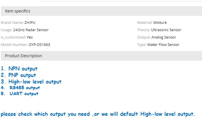

The DS1603 sensor can do just that: measure the depth of the water, when attached to the bottom of the tank. It also bounces ultrasound waves off the surface of the water. Not too expensive - RMB 85 on Taobao; around USD 25 on e-bay. So far one of the cheapest methods I've found for directly measuring water depth at this level of precision.

https://www.aliexpress.com/item/free-shipping-Ultrasonic-liquid-level-detecting-sensor-probe/32827257147.html
An ultrasonic sensor working at 24GHz ? ? ? ?
Tom.... :o :o
LOL that kind of things are so often wrong on aliexpress and taobao...
Best strategy is usually to look at the same product from 10 sellers, take the most commonly quoted (and most sensible) numbers, and normally you have the correct ones. Digging up manufacturer's spec sheets is a second strategy to the same. It's like instructables - they give you an idea of how it should be, but you have to do your due diligence.
Are those sensors for analog ‘level.’, or simply presence?
It looks like they may be on/off outputs. No proportional measurement.
Just saying... the description and photos haven’t convinced me.
The UART output is supposed to give an actual depth (and I guess the RS485 output as well - never looked that one up). The NPN and PNP outputs are indeed simple on/off outputs.
They can also be used as simple on/off switches, but I'd only use them for metal containers for that purpose. There are much cheaper ones that are capacitive based and work fine to detect water in non-metal containers.
