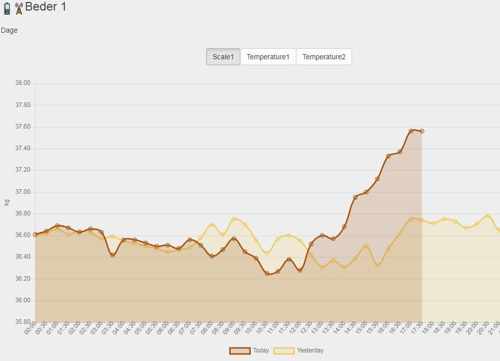

My last creation, a 4-point BeeScale. You are velcome to follow my scale on: http://www.minibier.dk My scale are named Beder-2.
Update every ½ hour at Sigfox net. Battery last more than a hole year.
