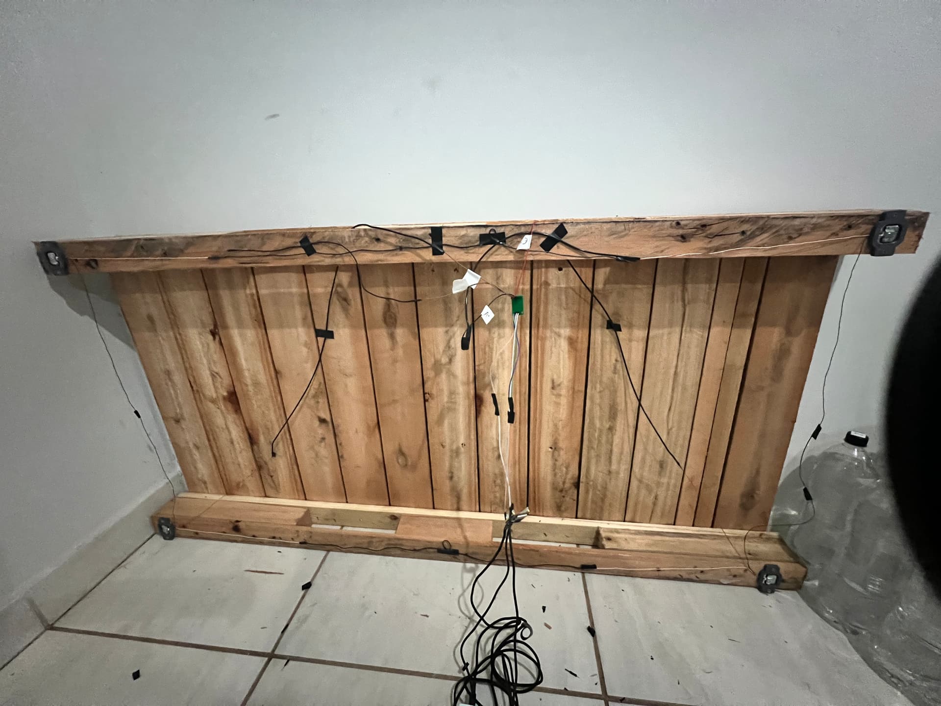

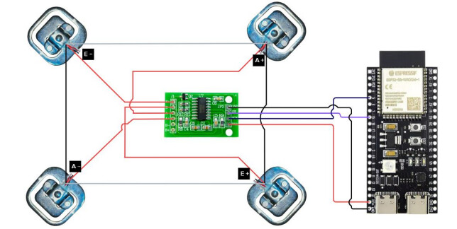

I’m trying to build a digital scale that will upload data to a database so I can monitor the stock levels of a specific part over time. I’m using four 50kg load cells, an HX711, and an ESP32-S3 DevKitC-1.

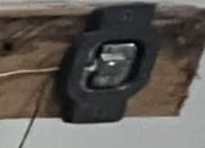

I assembled everything following the diagram below, where you can see both the theory and an actual photo of the setup, including all the connections.
However, the readings are very strange. I ran some tests I found in other posts, and one of them was to measure the resistance between the wires of the load cells. Here are the results, using a multimeter set to 20k ohms:

From what I understood in another post, the red wire should be the one connected to E+ E- A+ A-.
I’ve redone all the connections between the load cells, and also between the HX711 and the ESP32, but I still can’t figure out what’s going on. I’ll also share the code I’m using. I’m begging for any help to get this project working.
Top Right is the A+, Botom Right E+, Botom Left A-, Top Left E-

Hey there, sorry to reply on her behalf. I’m working on this project together with the OP. We’re using 4 load cells because we’re building a low-cost weighing platform. The platform itself is made from a pallet, with one load cell at each corner. The items we’ll be weighing can go up to 150 kg, so we went with four 50 kg load cells.
Those photos are of no help. A photo of a hand drawn wiring diagram is acceptable.

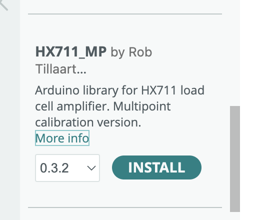

I built a scale with one load cell. I have no idea how you will calibrate and tare 4 at the same time. You may benefit from using this library
and here is the doc'n link https://github.com/RobTillaart/HX711_MP

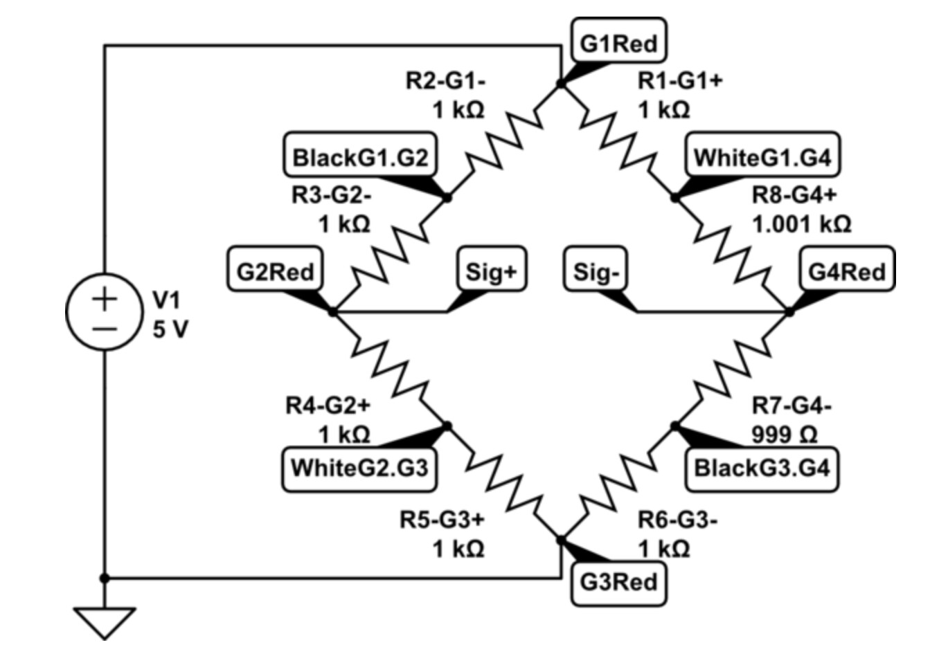

They look like three-wire half-bridge load cells with two strain-gauges per cell. If you carefully wire them up in a ring, you can have two strain gauges that constructively sum the strains in each leg of a wheatstone bridge between the half-bridge cell's center tap wire:
Where Gx represents half-bridge 'x', and nodes labeled like "WhiteG1.G4" represent the white leads from gauges 1 & 4. And the two resistors between the "BlackG1.G2", "G1Red" and "WhiteG1.G2" represent the two strain gauges in the G1-half-bridge. As per https://electronics.stackexchange.com/questions/102164/3-wire-load-cells-and-wheatstone-bridges-from-a-bathroom-scale/199470#199470
The resistances look OK as far as the 3-digit resolution goes, but the HX711 load cell amplifier needs much more precision. Each leg of the resultant Wheatstone bridge ends up with about 0.98K+0.98K=1.97K ohms in it, and the bridge needs to be balanced well within 0.020V/50V=0.4% or 2000*0.004=8 ohms. Instead of measurining kilo-ohms, try the millivolt range on your DMM and check that the A+/A- voltage is well within the +/-20mV range that the HX711 A channel needs so that "tare" will work properly.

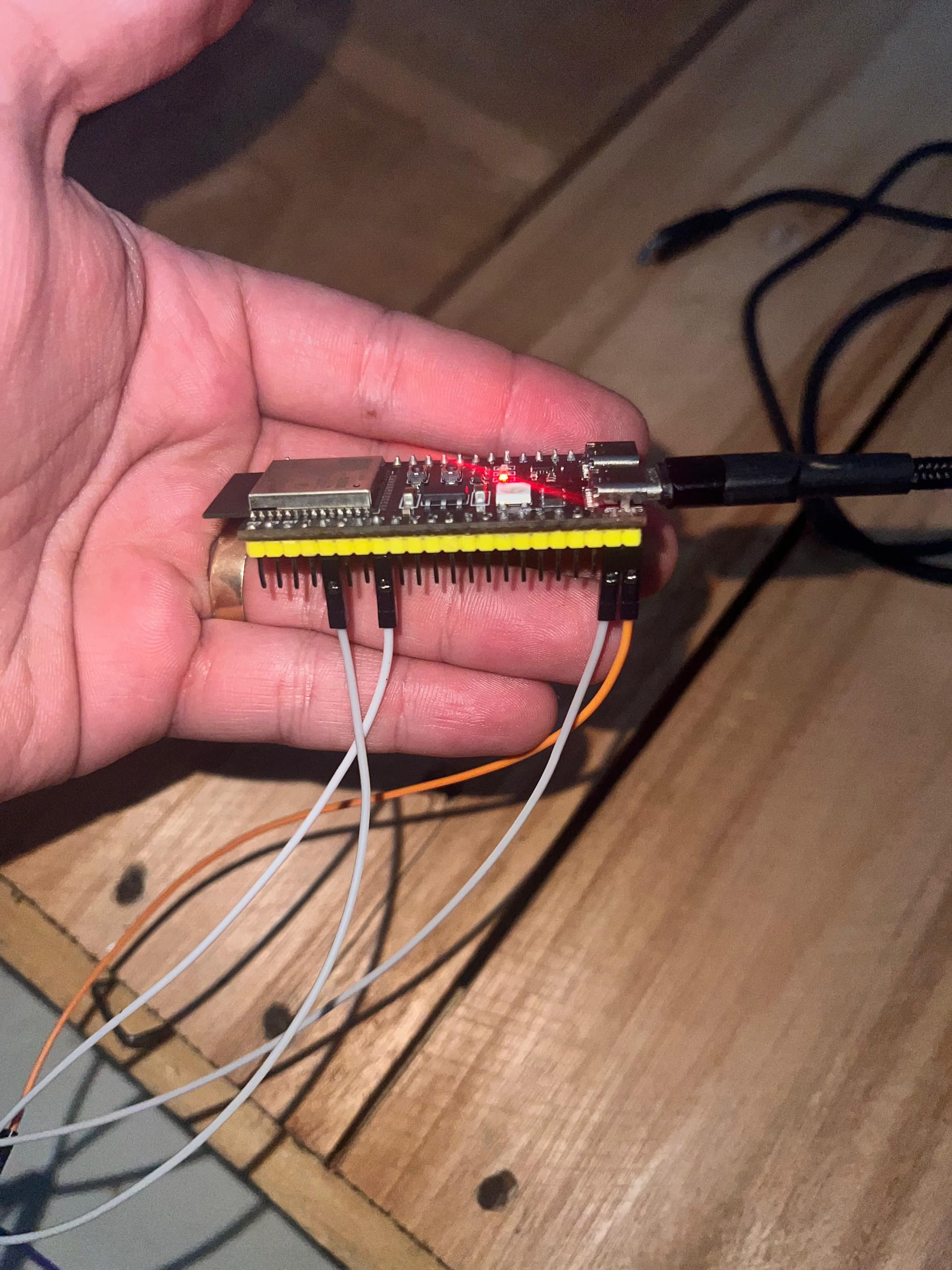

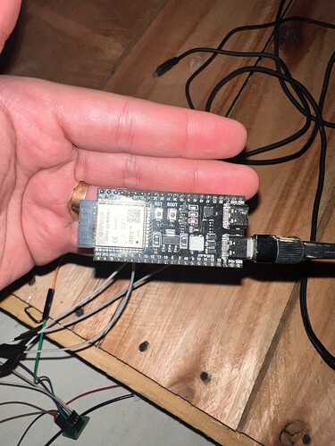

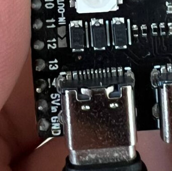

That HX711 board is 5volt-only.
The ESP32 is 3.3volt logic.
How are you going to solve that.
Leo..
the HX711 data sheet states
Operation supply voltage range: 2.6 ~ 5.5V
I have used the HX711 on an ESP32 without problems

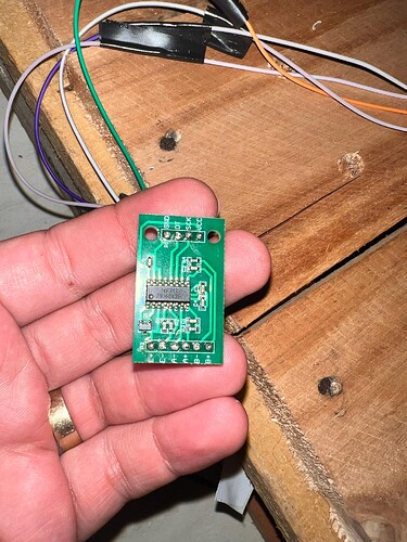

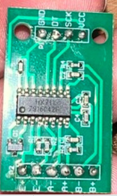

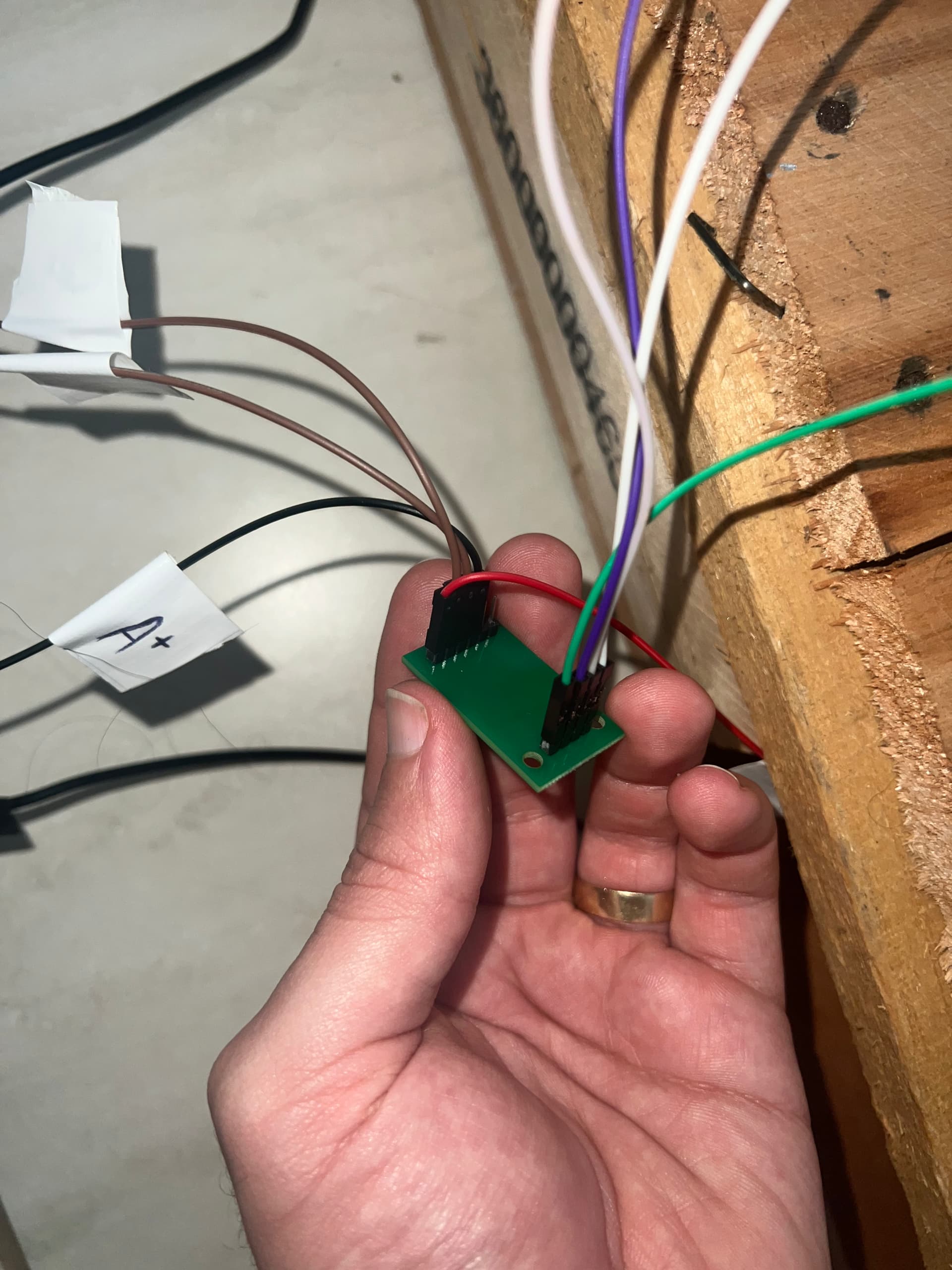

Looks like you have some very bad solder joints.
Did you solder this yourself?
That would cause crazy fluctuating reading.
Show each load cell and label the wire colours.

Some of those green boards have a manufacturing defect,
where E- is not connected to ground because of a missing ground plane.
The cure is to solder a short wire between E- and GND across the board.
OP should have used a Sparkfun HX711 board, which is designed for a 3.3volt processor.
The only option with this board is to power it with 5volt from the USB pin of the ESP32 and drop it's 5volt data signal with a voltage divider to 3.3volt. Not doing so could damage the ESP pin.
Leo..

Hi Wawa, Well, that might be a problem. My ESP32 has a 5V pin, so I just assumed it was a 5V output. So it doesn’t actually work that way?

Hi Jim-p, I’m attaching the GIF in this reply that shows the reading variation. It goes negative, fluctuating from around -41xxxxx to -37xxxxx.
This was my first time soldering, and I still don’t understand how you all manage to get good solder joints. With the ESP32, I actually had to pay someone to do it for me because I couldn’t get it right — the solder just wouldn’t stick to the metal pads on the HX711, it would only stay on the pins.

Hi Tom, excellent — here’s the image showing the exact connections we’re following.
I can and will buy it, and I’m also going to order another HX711 just in case this one is faulty!
