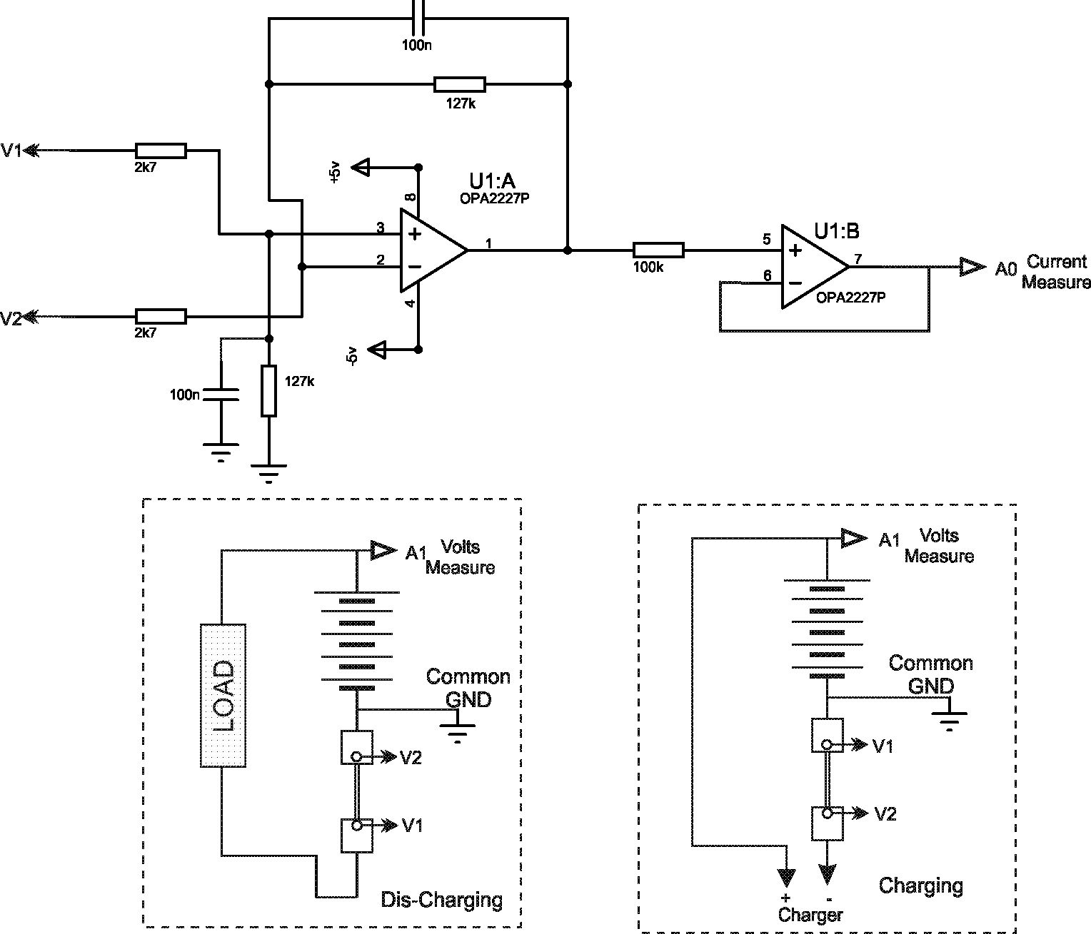

You're quite right about instrumentation operational amplifiers but I preferred to make my own, I've attached the cut down simple version of what I've used with very good results and my calculated results match my current fluke clamp meter in real time on the Arduino. It must run from +/-5V to get it down to Zero reading using a OPA2227A op-amp(I'm looking at other op-amps with low off set)But running it off with +- 5V OV offset is just 86µV . I went for this method has the other part of the circuit converts a negative signal into a positive signal which allows me to monitor current flowing in and out of the battery showing a minus sign when current is flowing in the opposite direction only using one shunt for high currents. But the cut down version does work for one way fixed applications(see drawing). Also attached is a spread sheet I used for my project for the formula I entered into my code, The code will follow shortly as it needs tidying up, I have used 4 line I2C LCD to display the real voltage that is been read by the AD1115 for both voltage and current then the calculated voltage and current readings. Once completed I will use 2x16 and only display the data I need to.The readings on my Arduino read exactly as my fluke meter and fluke current clamp does.
Some one may find it useful, I certainly enjoyed playing around with this project
OP-AMP CALULATOR.xls (1).zip (33.6 KB)
Fine on the circuit.
The usual instrumentation config with an separate opamp on each input is to compensate temperature drift in gain and offset that can occur.
Even 3 discrete opamp ICs in the usual config can do this compensate.
Tom..... :slight_smile:

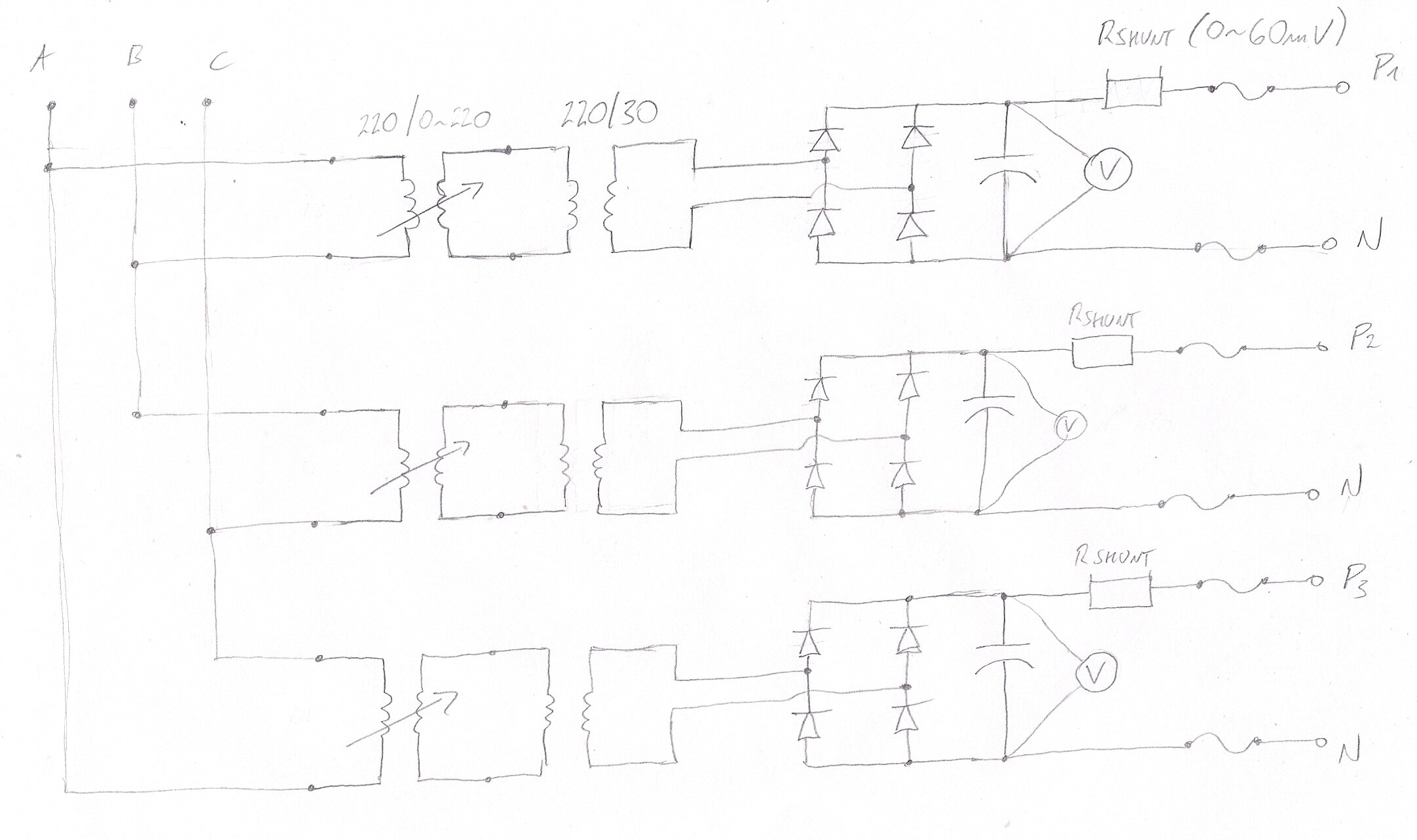

I think maybe it's better if I draw the circuit by hand and show it to you. But the whole project is really is to measure the rectified current, the voltage over the capacitor and the temperature over the diode bridge. All this three times, one for each phase.
Thank you!
I think we need a complete explanation of the application, analog inputs, 3 voltages and PWM sounds a bit strange
Do you have a circuit diagram to show us, a picture of a hand drawn circuit would be fine, in jpg or png.
Thanks Tom... :slight_smile:
Here is the circuit.
Thanks, Tom !
So you are just monitoring a 3 phase supply?
Rshunt is supposed to do what?
The voltage output will be too high for the arduino AtoD, it can only have a max of 5V, do you will have to use a potential divider.
Thanks... Tom... :slight_smile:
I think the key point is if the "N" (neutral) points can/will be joined (without the neutral fuses).
That will give a common ground for the three sources and the Arduino.
Without a common ground it won't be simple.
Leo..
TomGeorge:
I'm supposed to measure the voltage over the shunts (after amplifying with op amp) to measure the output currents (100A DC) on each phase. Is there an easier way? The thing is, I've already bought 4 shunts...
I'll also need the voltages on the capacitors and later the temperatures on the diode bridges.
And yes, about the potential divider, I knew that !
Thanks!

You could use the circuit I posted for the op-amp setup to measure current , But this all depends like Leo said in post 15 is there a common ground on the circuit ?
If yes then it's simple if no then this makes it harder unless you use an Arduino board per phase, there is away bit then design gets more complicated using an I2C ADC converter for each phase along with digital I2C opto-isolator then you could use one Arduino for the lot.
But this all depends if you have a common ground ????
Thanks for the answer !
No, I will not have common ground all the time.
I'm thinking I'll just use one Arduino for each phase. It's much easier, since there will be no need to multiplex the signals, and it's less likely to have errors.
So for each Arduino there will be three analog inputs. One voltage measurement over the capacitor (Arduino dc voltmeter), one voltage directly output by the op amp over the shunt, and one temperature measurement over the diode bridge. All of these to be displayed on LCD displays.
