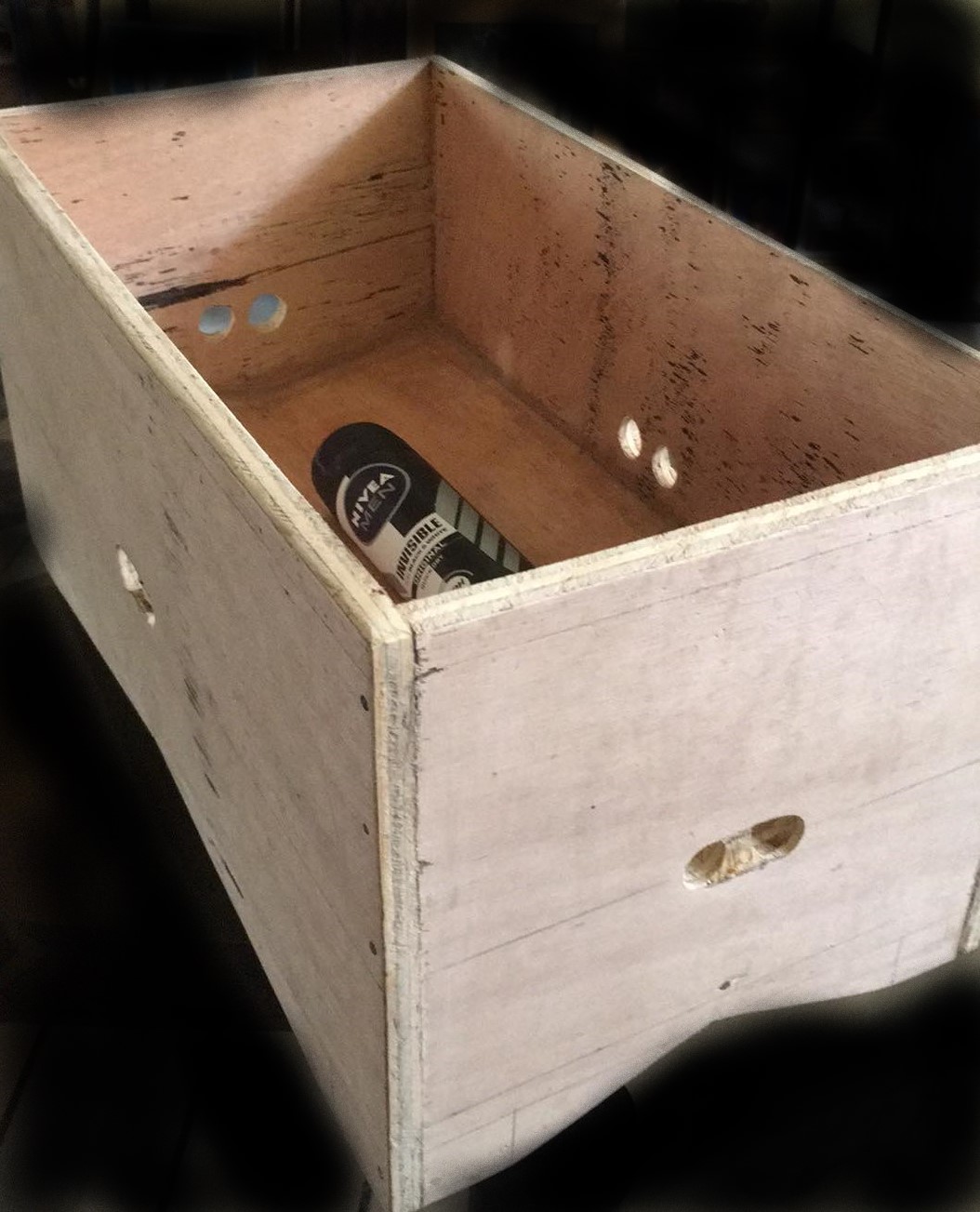

Currently I'm having trouble with the module I'm working with, the volume measurement module. I have made the module by putting 4 ultrasonic sensors on an enclosed container. When the user deposits a bottle, the 2 width-side sensors will measure the distance between itself and the bottle and subtract that measured distance from the total width of the container which gets me the approximate diameter. The 2 length-side sensors will also measure the distance between itself and the bottle and subtract that measured distance from the total height of the container to get me the height of the bottle. I then use the gathered values to calculate the volume by using the circular cylinder formula πr²h. I did not use the ultrasonic library for me to be able to get double type values. See attached image for reference:
x - (x1+x2) will give me the diameter while y - (y1+y2) will give me the height.
My problem is that the values vary by where I put the bottle due to its different shape. The values of the sensors also jump to unrealistic values like over 100cm which is greater than the dimensions of my container. Are there any accurate method to measure volume of PET bottles? Thank you

If the ultrasonic sensors are working inside a container then I suspect there will be lots of echoes to confuse them.
To my mind measuring the weight would be much simpler.

Yes, the ultrasonic sensors are inside a wooden container with no ceiling. Will fully enclosing the container improve the accuracy of the sensors? Also, how would I get the volume of the bottle by getting its weight?
Are you trying to use all the ultrasonic sensors at the same time?
I would imagine that you have to use them one at a time, and sequentially with the others inoperative so that they don't interfere with each other.

I think it would make things worse. Removing the enclosure would improve things.

PET volume is (most often) proportional with base diameter. So why not measure only the maximum diameter of the bottle?
One cant measure the volume anyway using sensor alone, because the bottle shape varies.

I have programmed the volume measurement by having the sensors get a distance one at a time by an interval of 100 microseconds. To those who would like to see the actual code, you can view it here

100 microseconds may be too little time to let echos die down from one sensor before triggering the next. You may need to wait longer between pings, depending on the character of the chamber.
The construction of the inner part of the chamber will have a large effect on the strength and duration of the echoing. A hard smooth surface will reflect much more than a rough "soft" surface. Look into anechoic chambers.
