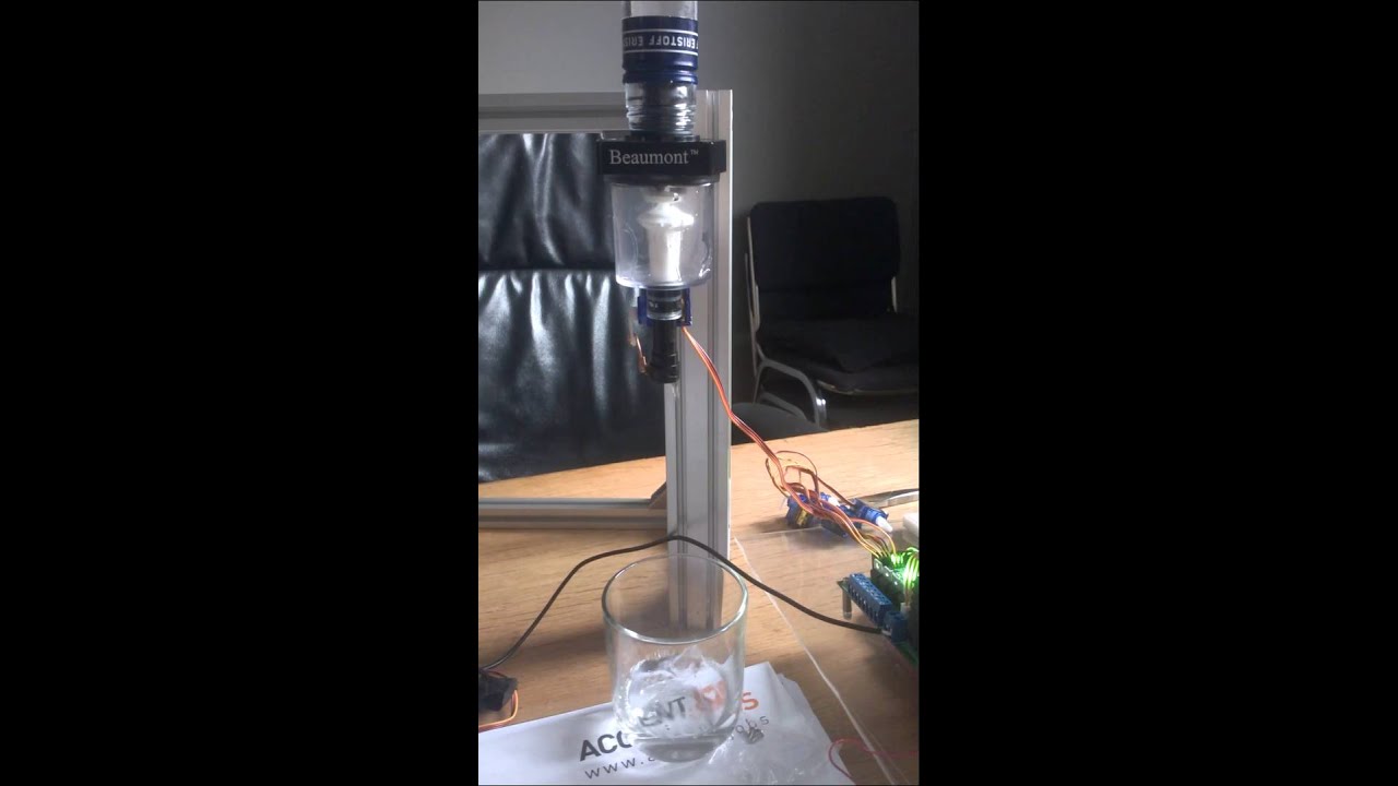

I will have a 'tray' that is being moved left/right and stopping under each 'bottle'.... at this point I need to trigger a servo/linear servo to vertically lift up and dispense the liquid.
I saw this video:
But I cant clearly see how/what they are using as the mechanical parts? I see the hobby servo? but what is making contact with the 'shaft' that comes out of the optic/dispenser?
The 'shaft' can only go up... its not a 'pull/trigger' type... but a vertical movement.
The travel is pretty small as well.. I havent measured... but roughly 1-2inches tops.. (probably more towards the 1 inch side of things)
I tried to for some linear servos... but they were either tiny/hobby look devices (that didnt seem to fit the build).. or the one that seems to fit was like $70 or so!!
https://www.actuonix.com/Actuonix-PQ12-R-micro-linear-servos-for-RC-p/pq12-r.htm
The fastest one is the only one that I think may work.. but the price is kinda high.
Bonus is seems run on 6v
I didnt think a hobby servo would have enough torque.. but the video seems to show otherwise?
I just cant wrap my brain around HOW its working.. since the hobby servo 'arm' will move in a circular motion.. where it needs to be vertical? So some sort of attachment that keeps contact with the 'stem/arm' of the dispenser.. and lifts it up even though the arms is going in a circular pattern?
