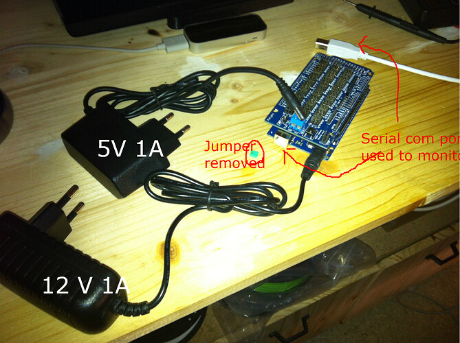

I got a mega sensor shield has recommended, but I think I burn the mega :o(
I put five volts to the sensor shield and twelve to arduino. I remove the jumper from the shield.
Is it ok like this ? because I suspect a bad manipulation from me... But I dont want to burn another mega.

I would like to see a link to your specific mega sensor shield to be sure, but it does sound like you did it properly. Removing the jumper on sensor shield should 'isolate' the arduino board's 5V pin such that any sensors wired to the sensor board will draw 5 vdc current from your external +5vdc supply wired to the shield board. At least that is how my Uno type sensor shield works and I've confirmed that with an ohm meter.

I have the same as terryking setup, featured in his above picure.
=( I burn another one mega
I join you a capture of my setup... but maybe my shield have a problem (I cut some too long weld under so nothing touch)
Thank's ded.

Finally I got it working. I changed the I/O shield, and place some tape on the new arduino usb port, it was touching the shield. And I'm seriously thinking wearing gloves when manipulating my setup.
Can you just confirm me that the config on my last picture is correct ???
Of course the 5V on the picture is plugged to the blue connector properly.
Thank's a lot, ded.

That looks right.. The Mega only "needs" 9V, but the 12V should be fine. In your configuration there is very little current coming from the onboard 5V regulator on the Mega.

I hesitate suggest you to add a picture like that to your website and may be adding a complete setup picture too (with the two DC adaptater) because it's not so intuitive for a newbe like me.

Ok so here is my setup....
As Napoleon said.. A picture is better then 1000 words 8)
I still have a "leak" of power when I connect the sensor shield. Any idea from where it could come ?
Is it a short cut or a normal behaviour about missing something ?
