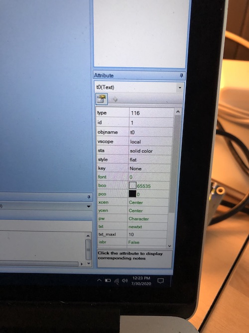

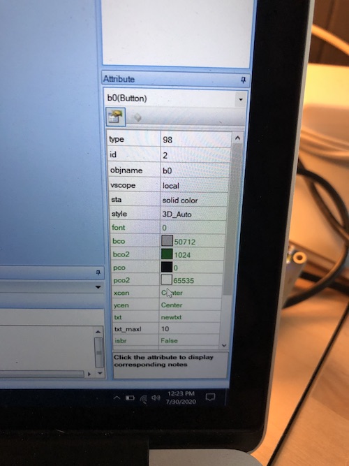

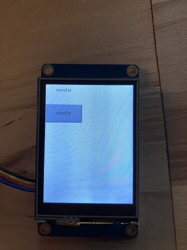

I have in fact followed your tutorial but I get similar results. The Nextion displays both pages, which I can switch through using the Page 0 and Page 1 buttons. The program loads onto the Arduino without any errors, but there is no change to the Nextion display as instructed by the Arduino code.
For another example, here I've attempted to strip down your tutorial code to the most basic of functions - simple update the text on the Nextion display.

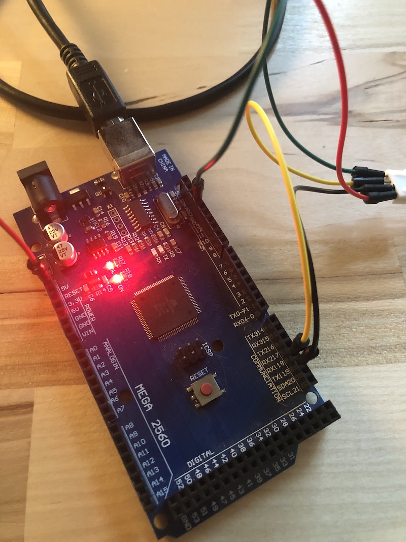

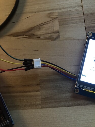

Thanks again for your input - I've updated my previous comment to include another example and a photo of the connections. I've swapped out the jumper wires as well but still no luck.

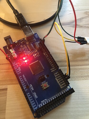

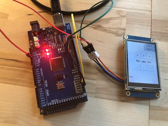

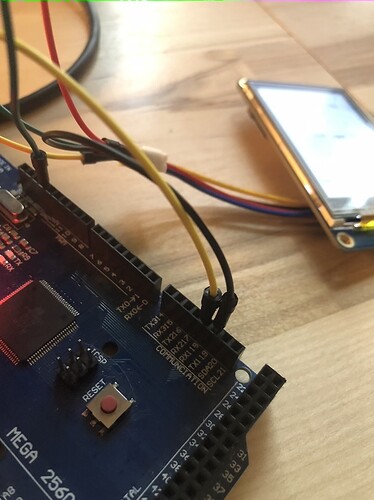

None of your photos show the connections to the Mega... How are you making the connections?
If you use my Nextion file and my code then you can be sure those are OK. That leaves the connections or the possibility of a faulty Nextion or faulty Mega.
Hopefully these photos will make it a bit more clear.
I do think it's possible the Nextion is faulty.

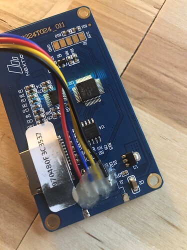

Unless ITEAD are now supplying different cables to the ones I got with my Nextion displays you seem to have the end of the cable that is supposed to go to the Nextion connected to your Mega, that being the case how have you connected the other end to the Nextion?
Yellow wire in particular does not look connected very well to me.
PerryBebbington:
Correct. You then have to change all your Serial1s to Serial2, and I can guarantee that when you do that you will miss at least one, which you won't be able to find.
Too true! Thanks for the clarification on that.
You're right - the connector on this has been modified. I've purchased this as part of a kit to fit into an electrical box. https://www.haswitchplate.com/
I was hesitant to believe the work on this was faulty but perhaps I need to peel off the super glue and check the solders underneath.
I've swapped out the jumper wires a number of times and tried to be super diligent about the connections between the devices.
I suggest you take those wires off and replace them with some that can go bare ended into your Mega connectors without the bodge connection in the middle. Use a wire size that fits comfortably into the Mega connectors. If it's stranded then put a little bit of solder on it, just enough to keep the wires together.
That's all from me tonight, far too late for this kind of this now (UK time 23:19)
