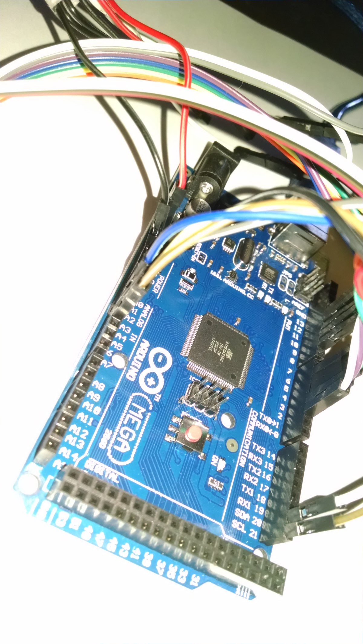

Please forgive what I'm sure will be a stupid question. I'm an Arduino newbie working on my first project. I have some VB6 programming experience but no C+ experience at all so the syntax and formatting throws me off.
I'm trying to merge the BME280test and the NRFLITE Dynamic TX library examples to make a temp sensor I can put outside to radio the info inside.
I merged the code in what made the best sense to me but when I try to upload it to the Mega i get a message that reads " 'printValues' was not declared in this scope" and I don't know why.
(I also want to add Photoresistors for Sun Tracking - that is addressed after the problem code. That code works and I can merge it with the BME280 code so if I can merge the BME280 and MRFLITE codes I'll be able to merge that code without problem)
Someone please enlighten my to my ignorance. Code follows:

To make it easy for people to help you please modify your post and use the code button </> so your code looks like this and is easy to copy to a text editor. See How to use the Forum
Your code is too long for me to study quickly without copying to a text editor.
Also use the AutoFormat tool to indent your code for easier reading.
And please display your image(s) in your post so we can see it(them) without downloading it(them). See this Simple Image Guide
I am not familiar with the NRFlite library (never heard of it before now). I use the the TMRh20 version of the RF24 library. This Simple nRF24L01+ Tutorial may be of interest.
…R
Sorry, Thanks for the posting tips
Rather than think about merging those two programs can you first identify the data variables in the BME program that you would like to transmit?
Also, there is no point writing a program to transmit wireless data without having a matching program to receive the data.
Have a look at the examples in my tutorial - they are all in matching pairs and I have designed them to be as simple and obvious as possible. If you just want one-way transmission then the first example should be a good starting point.
...R
Actually I found code that works better but I am still having trouble merging my code.
I have a second setup with an Arduino Uno and an rf24 and works ok sending the “hello worl” message from the code and I already have a VB6 program setup up to put the temp, humdity, and pressure values from the serial buffer and it works fine.
my problem is merging these codes and then changing the message transmitting the values recorded from the sensors

This project just went on hold for about 2 weeks. I have 2 radios, 1 Uno and 1 Mega. The uno and radio attached work fine. The Mega radio doesn’t work on the Uno and the Uno radio doesn’t work on the Mega. I suspect somehow I ESD’d them. It will be a couple weeks before I can spare money for replacement parts. However, this has made me rethink the radio idea. It was ideal for outdoor use, but now I think if I have to buy a new radio anyway, maybe try Wifi or just suck it up and sting 50’ of Cat5/6 and use an Ethernet board.
Any suggestions?

This project just went on hold for about 2 weeks. I have 2 radios, 1 Uno and 1 Mega. The uno and radio attached work fine. The Mega radio doesn't work on the Uno and the Uno radio doesn't work on the Mega.
I presume you are aware that the MOSI MISO and SCLK pins are in a completely different place on a Mega? They are pins 51, 50 and 52. And SS is 53. The SS pin must be set as OUTPUT for the Arduino to act as SPI master.
On what evidence are you saying that the Uno and radio work fine if you don't have a working radio on the Mega to prove that? Maybe I am misunderstanding what you are saying.
Have you tried the connection test (I think it's in Reply #29) in my Tutorial. It will verify whether the Arduino can communicate with its own nRF24. Of course it does not prove that the wireless part of the nRF24 works.
Debugging wireless problems can be very tedious. You must be very methodical.
By the way a couple of nRF24s is probably cheaper than 50 feet of CAT 5 cable.
And if you are buying more nRF24s buy an extra one for a spare against which you can test the other 2.
...R

BobCatEndeavors:
Yes I know the pins are different. I am basing it on the fact that it used to work until a cat pulled it off the desk by the cord which caused me to grab the cat, move him and pick up the mega and radio, after which it stopped working
It would have saved a lot of time if you had said that in your first post.
Just get a new wireless module.
...R
It didn't happen until post #10 (at one point I did say prior to that post that things were working and all I needed to do was figure out how to get the radio to transmit the readings.)
Also, if the working radio that is connected to the Uno doesn't work on the Mega why do you think a brand new one would? (I did say I had 2 and already tried swapping them.)

Right there I said that everything works, that I had 2 and it worked sending the "Hello World" message. all I needed to do was change the message from "Hello word" to the bme readings
Post #12
I have 2 radios, 1 Uno and 1 Mega. The uno and radio attached work fine. The Mega radio doesn't work on the Uno and the Uno radio doesn't work on the Mega. I suspect somehow I ESD'd them.
I restated the setup and said I possibly ESD'd (Electro Static Discharge) them. No I didn't go into the details of how the damage occured but I did indicate possible damage, i.e. change in circumstances.
Here's the test I used.
At Post 4
I had both the Uno and It's radio and the Mega and it's radio both hooked up and viewed them using the Arduino Create Monitor. The Monitor on the Uno stated it successfully received message "Hello world" from Radio 1.(Radio 1 being the radio on the Mega)
At Post 12
no coding or wiring had changed however damage had occurred
The monitor for the Mega now said Cannot communicate with radio
The Uno gave no errors.
then I swapped the 2 radios
The Mega still said cannot communicate with the radio
but now the Uno also said cannot communicate with radio
when the radio's were switched back the Uno gave no errors but the Mage still did.
I then removed the BME and Photo Resistors (both of which worked fine, I removed them to eliminate them as a possible cause) from the Mega and tried again with the same results
