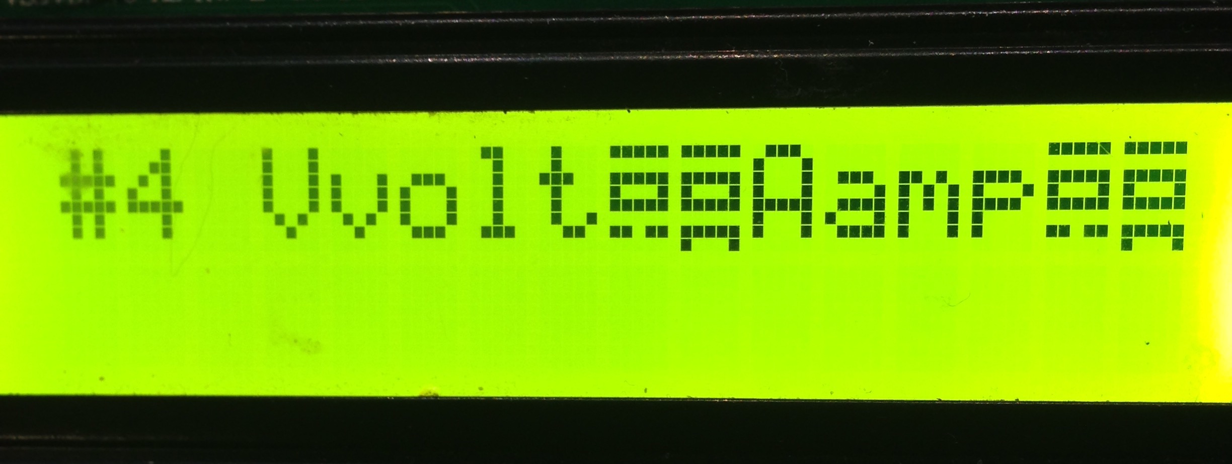

Mess on the LCD menu <solved>
Hi
How to get rid of the mess on the LCD?
I have it on all cases .

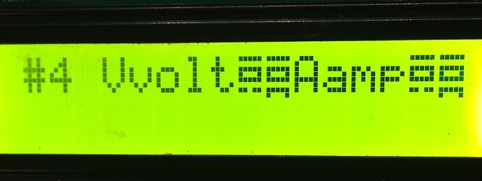

On LCD should be
#4 Volt Amp
instead of
#4 Volt??xx Amp xx??
Which mess?
Hello tom321
We need some additional information.
Post your complete sketch, well formated, with well-tempered comments and in so called code tags "< code >" , a real schematic and a picture of the solderings of the LCD to see how we can help.
Do not use println(). The println function is not supported by any of the LiquidCrystal libraries.
