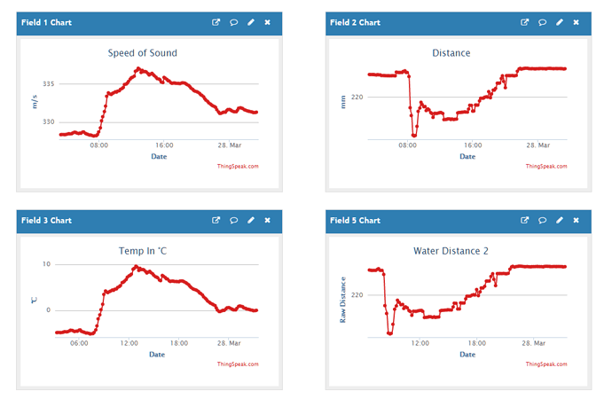

I'm making a project that measures the distance of water and I need a way to be able to calibrate my ultrasonic sensor (JSN-SR04T 2.0) so that it doesn't fluctuate with temperature or at least not as bad. currently when it gets hot outside that makes the speed of sound goes up and so my ultrasonic waves travel faster and it makes my distance go down on the graph and then at night when it's cool the waves travel slow and my distance graph goes up. are there any sensors that can be used with Arduino to get the speed of sound? I I'm currently using a ds18b20 sensor to get the temperature and then converting that to speed of sound but that does not appear to be doing anything as my graph still has high and low fluctuation even though it's measuring a bucket of water that does not change depth... I had a suggestion to use another ultrasonic sensor to measure a fixed distance and calculate speed of sound off of that but I had a colleague who tried that and he still got a graph that varied a lot, also I'd like it to be minimal in size and not have to use two ultrasonic sensors with a tube measuring a fixed distance. In my research of speed of sound calculations I read over a forum that said humidity and air pressure have minimal effects on speed of sound compared to temperature so I don't know if I need those in my calculations... Any suggestions or guidance would be greatly appreciated - thank you.
Did the adjustment for temperature reduce the fluctuation? It would be interesting to see the data you've collected.
As I understand it, at fixed altitude, temperature will be the dominant term, but pressure and humidity have an effect. So the possibilities include at least the following:

It does do something but it's not flattening it out as much as I would like it cuts the fluctuation and half but I was hoping to cut the fluctuation down until it was negligible.

Sorry that was a typo my speed of sound graph does increase when it gets hot and decrease when it gets cold. My bad. It's not an error in the code because if I make the speed of sound a fixed number instead of calculating it it has pretty large fluctuation but if I put in the current speed of sound the fluctuation is small but is still there. Without speed of sound calculation the fluctuation can vary up to 60 mm with the current speed of sound its varying about 30 mm.

What I don't know if I'm doing correctly is calculating the speed of sound... I found some formula that only required temperature to give me the speed of sound.
SOS_in_air = 331.3 * √(1 + T/273.15) [m/s] for T in °C
I think I put it in the code right? Im not sure if thats even the right formula...
calcSpeedOfSound = (331.3 * sqrt(1+((calcRefinedTemp / refinedTempReadings)/273.15))/1000);           //calculate the current speed of sound
It had this also written in the article I took it from
Did you notice something interesting? The speed of sound in the gas depends only on two constants - γ, R - and on the temperature but not on the air pressure or density as it is sometimes claimed. The humidity of air also has an effect on the speed of sound, but the influence is so small that it can be neglected. The temperature is the only important factor!
Your sensor returns the time for the very first echo it hears. Are you waiting long enough between pings for all the echos to die out? Can't tell from the snippets.

You forgot to include the Y scale increment for the graphs on the right side of the figure.
The speed of sound in air varies by about 2% over the temperature range of 0C to 10C. So you would expect to see the estimated distance change by 2%, or about 4mm out of 220mm, if you assume constant sound velocity.
If the change in distance is still observed after applying the temperature correction, then either your program is wrong or some other temperature dependence has a larger effect. I would bet on the first possibility.
However, I doubt any of us wants to wade through 350 lines of code to figure out what might be wrong with a calculation that takes two lines of code.
