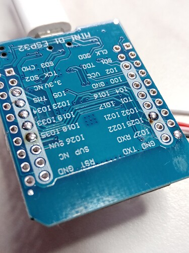

What voltage does the MFRC522 use and how is it powered bearing in mind that the ESP32 is a 3.3V device
Thanks for reply @UKHeliBob. The MFRC522 is powered from the ESP32 3.3V and the ESP32 is powered with the USB Micro.
Sending images:
I think that I have maybe wrongly connected the ESP32 with RS522.
In another forum I have find out that I can't use all the GPIO's for RS522.
I'm new to this, if you could take a look if this is ok what I have connected.
I'm using an ESP32 D1 mini
And my wiring is:
RC522 > ESP32
SDA > I05
SCK > I018
MOSI > I023
MISO > I019
IRQ
GND > GND
RST > I022
3v3 > 3v3
Is that ok?
