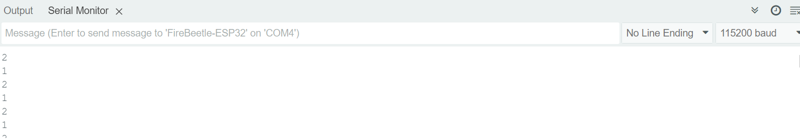

That does not sound like a very good idea. Are you sure that the "servo" is not taking too much current and causing the processor to reset ? Add some print statements to the sketch showing what it is writing to the "servo"

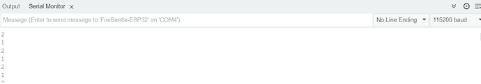

  myservo.write(0);
  Serial.println("1");
  myservo.write(180);
  Serial.println("2");
The loop has been correctly executed?

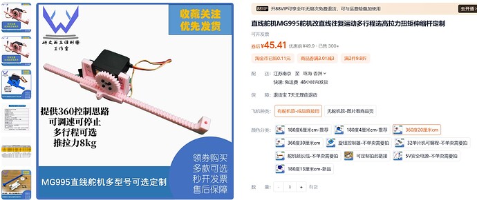

From the webpage you gave the link to:
There are many counterfeit servos of TowerPro from China dealers selling on eBay, Amazon and Alibaba websites.
For ¥3.9 it has to be a fake
Oh that 3.9¥ price tag is a clickbait, the actual price is 45¥, I agree it is fake tho

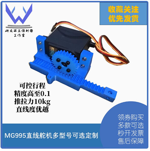

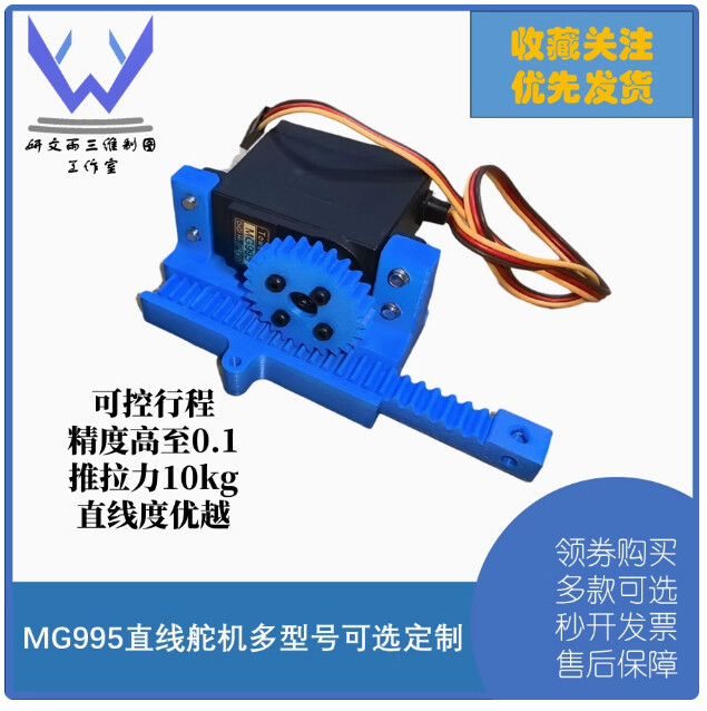

That would be a very strange way to use a continuous rotation "servo", particularly given this description
Linear servo MG995 servo modified linear reciprocating motion multi-stroke high tension torque telescopic rod customization
I bought this one
