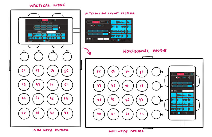

Hi! I am building a midi controller to be used with an iPhone and Koala Sampler app.
The device has also an usb hub with audio output and a powerbank. The board used is Teensy LC. There are 23 buttons and 4 leds. The whole project was inspired by youtube user Moby Pixel. His tutorial was very helpful.
Code provided by the author using Control Surface library works great:
I am trying to extend the functionality of the device, but had little succes, since I am new to coding:
**1) 4 smaller buttons should change the midi channel of the 16 buttons below. 4 leds next to the buttons shoud show which one of the 4 channels is selected. **
2) the device shoud be able to switch from vertical to horizontal layout by the bush of a button.
Please help with the coding!
board pin numbers and functions of the buttons
vertical to horizontal switch button

// 4 Channel Selection buttons. When pressed, main 16 buttons change to the respective midi channel. Respective led lights up. Should not send midi notes.

// One button that switches the orientation of the device from horizontal to vertical and back. Only the main 16 buttons are affected. Shoud not send midi notes.

You might want to use banks: Control Surface: Frequently Asked Questions
