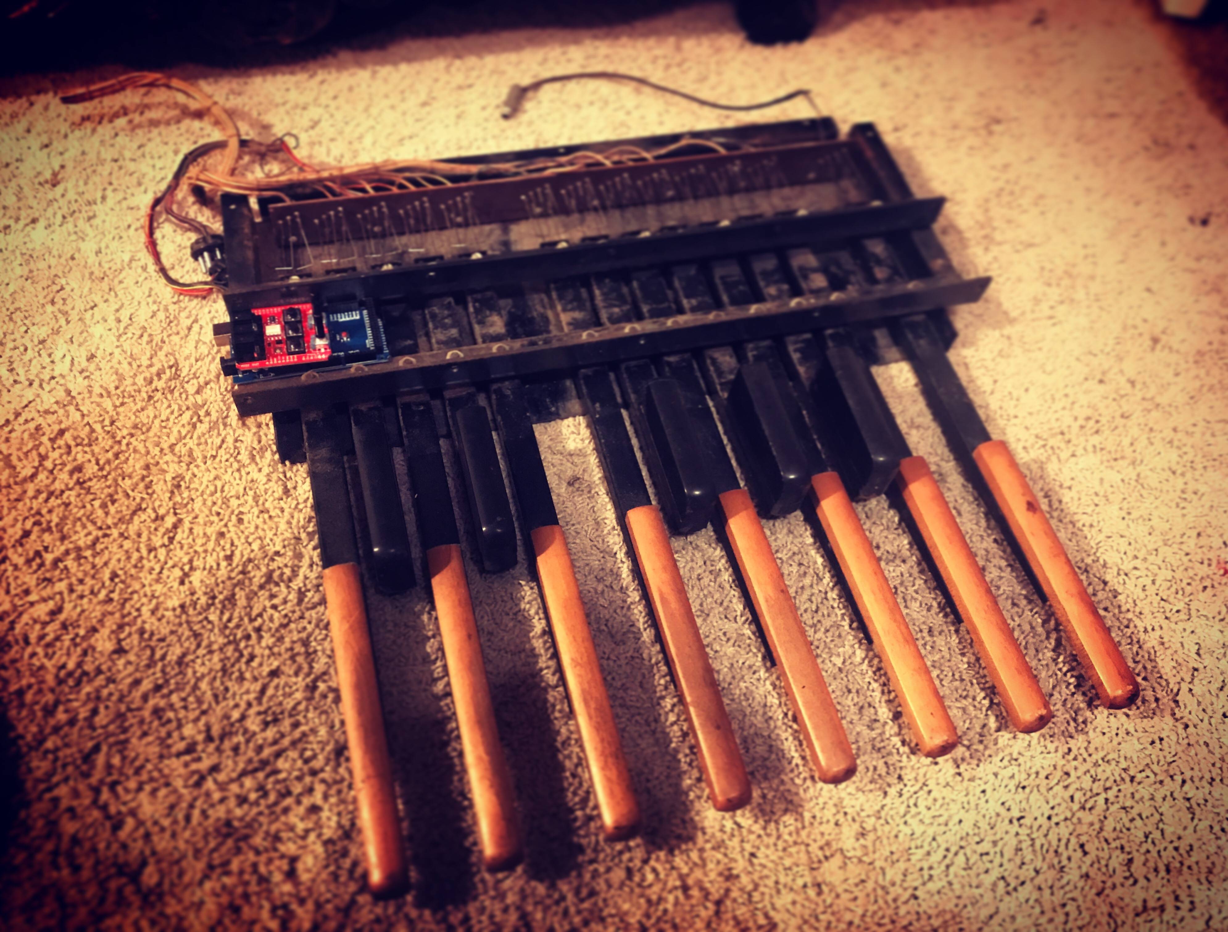

before soldering was all done photo. finishing up the outer casing soon.
UPDATE
lol....So I got the LEDs to work the way I wanted them to!......but then the midi notes wouldn't turn off... RIP
DAY 2 in Arduino IDE is very intense and many curse words have been said, but I'm starting to be able to read the language a bit better.
