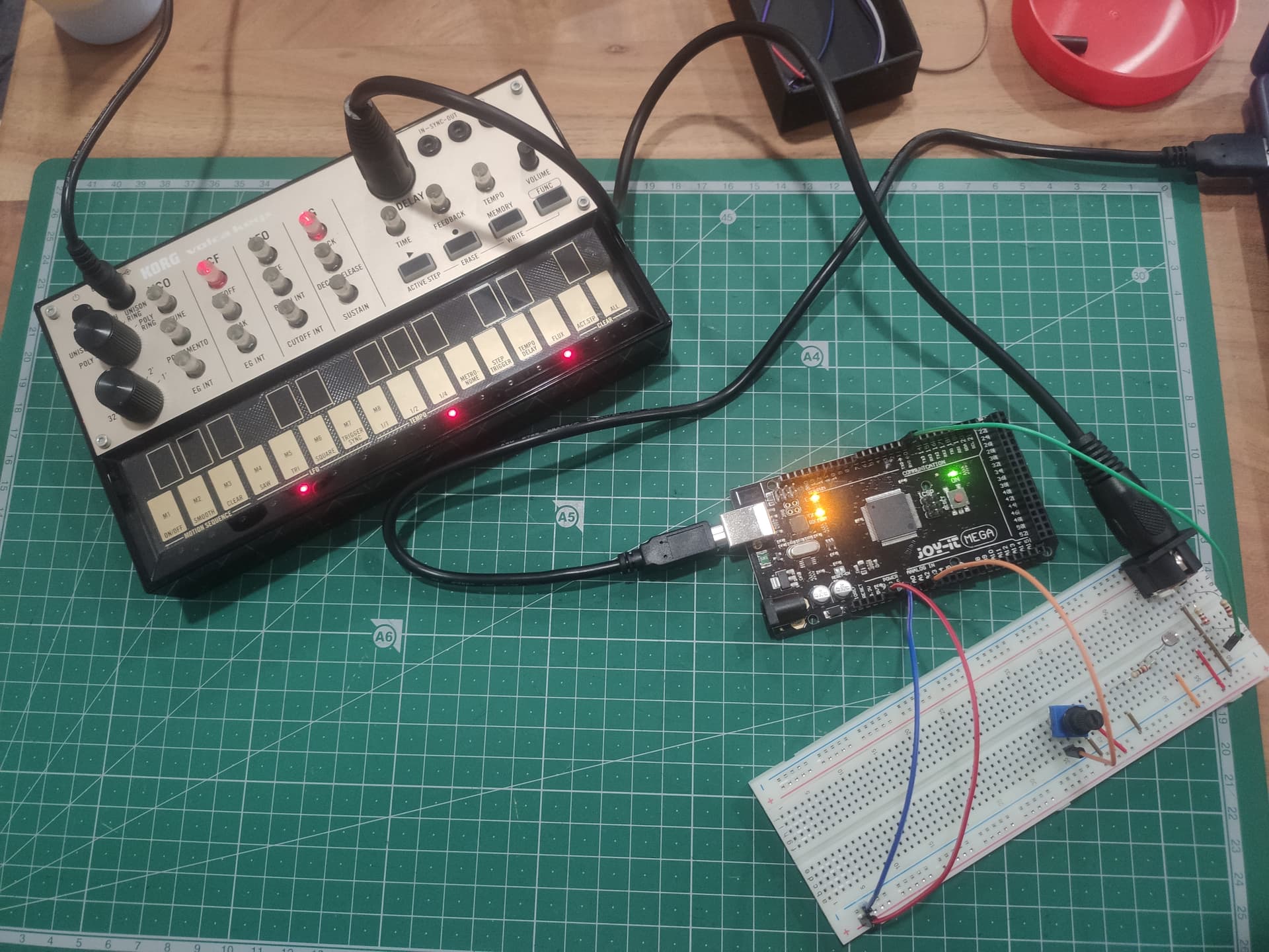

Hello everyone! I'm quite new to electronics and coding, but I decided creating custom MIDI controllers for an art instalation for a uni project would be a great way to teach myself. However, I am completely stuck after spending two days reading up on everything about it I could and looking at other people's code and tutorials. The idea it to use a bunch of cool sensors to control various aspects of the music that's playing and set all of it up as an instalation where people can come and have fun and create music with others.
I began by building a simple DIN MIDI output and tested it on the arduino and it works fine, it sent MIDI notes to my volca keys with no issue.
Then I decided to start small and add an LDR to control the cutoff. I tested a simple LDR circuit and it worked just fine. Then I tried adding the MIDI library to it and I just can't get it to work. I tried the same code with a regular 10k potentiometer and it kinda worked, I could adjust the cutoff, but multiple knobs were still lighting up meaning more than one MIDI CC is getting a MIDI message from the arduino.
I am using the Arduino Mega 2560 clone from Joy-it, and I've tested this code on two different synths. The serial print values make no sense what-so-ever too.
Anyway, here's the code:

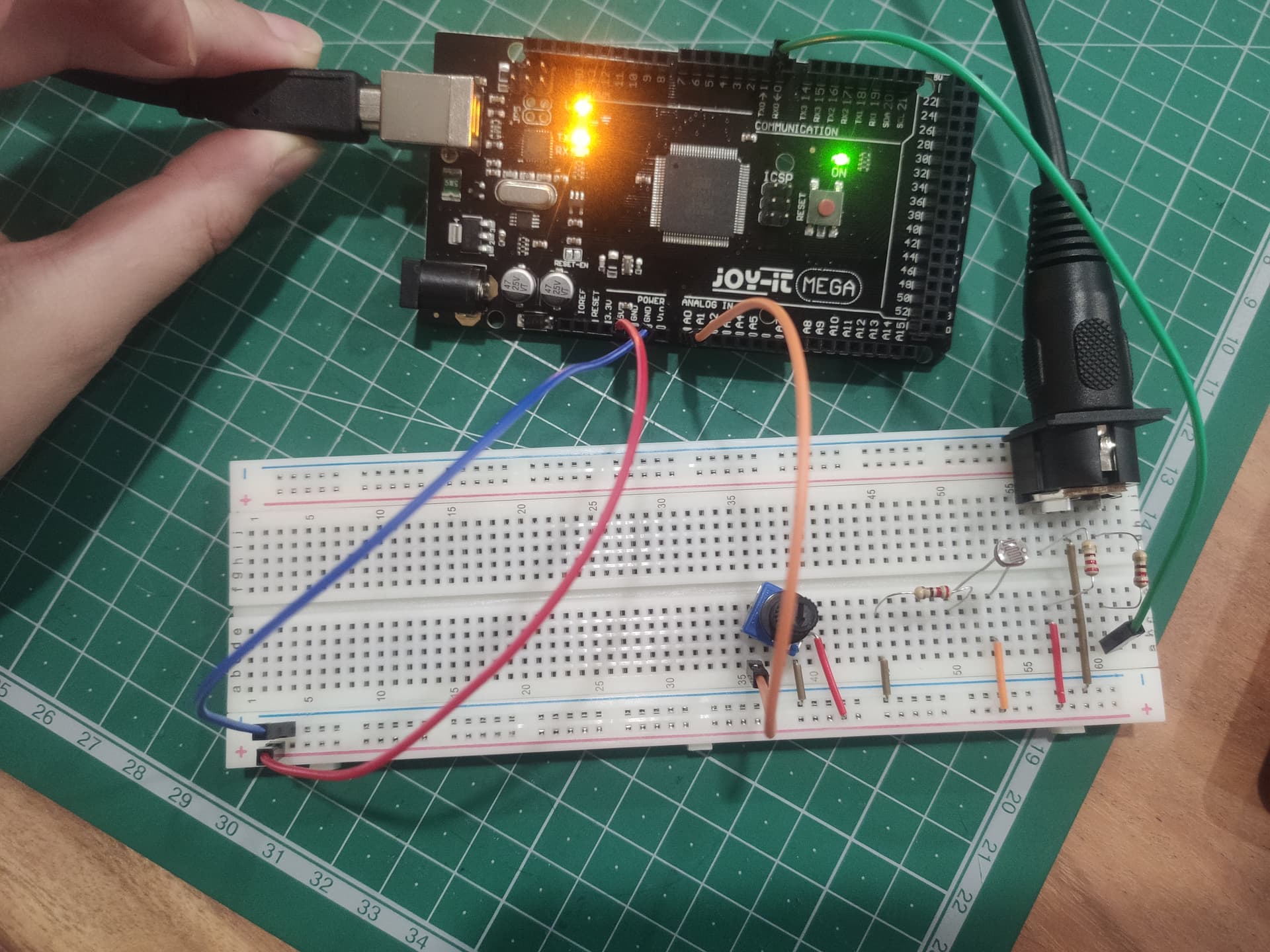

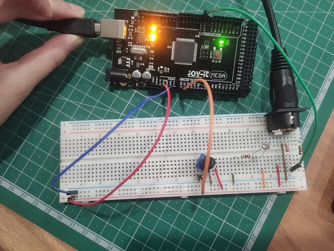

And here's a couple pictures of my breadboad, I have both the potentiometer and the ldr here and I just swap the orange cable to test one or the other.
I'm sure I'm missing something really basic, but I am still in that point where I don't even know enough to know what I don't know xD What is wrong with my code?

Maybe shift the MIDI to Serial1 and pins 18 & 19 per or MIDI Library, For Communication With Musical Instruments
to keep your Serial.printing from getting confused with the MIDI communication.

That worked! It's no longer sending random extra MIDI messages to the Volca either! Thank you so much!
Next step, finding out why the potenciometer works perfectly but the LDR doesn't. edit: I'd assembled the circuit wrong :person_facepalming:
Thank you once again, Dave ^^
