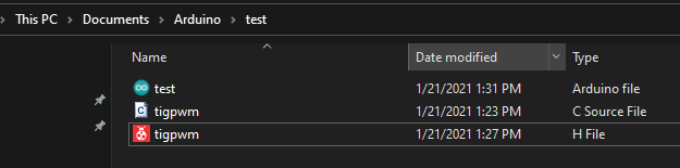

It's going to take me a while to figure this out. If I use a PWM signal, can I adjust the overall frequency of the wave and adjust the duty cycle without changing the overall frequency? Also, I understand these MOSFETS are limited to around 500KHZ which is why I chose around 300KHZ for the start pulse. I don't think duty cycle matters for that but it's something I will have to experiment with. So far, it looks like my panel will have a POT for HZ, one for the duty cycle, and the LCD. I might could add a POT to play with the start pulse but that will only be monkeyed with until it works right and never again.
Thanks for all the help. I just need to learn more coding so I can figure it out. I'm just figuring out how to set up libraries manually.
I wasn't able to open these libraries in the Arduino IDE. I was able to open them in a word processor. I'm guessing you did this in straight C++ and used a compiler? I also noticed it looks like you are using direct port manipulation. I appreciate the help, but I'm just learning programming and this is just way above my head. I found a library "avr/io.h" within your library. Is that meant for your compiler? Is there any chance I could get you to just paste the code into one sketch so I can at least handle the file as one piece? Maybe some day I'll be able to figure out what you have done. For now, I'd like to just be able to figure out what to wire to which pins just to see what happens.
It's for my compiler but the Arduino IDE already includes it so you don't have to put that in. You can just combine everything in a single sketch and the Arduino IDE does all the magic. The details are dirty, but that applies to any library that you didn't write.
Try out notepad++
Please tell me more about this.
hzrnbgy:
