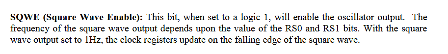

I find this description in the DS3231 data sheet rather confusing because it appears to mix (a) user instructions for setting the registers with (b) the normal behaviour of the INT/SQW pin.
It is not clear if the 500ms high transition referred to is a special case following a time update by the user or a regular activity by the device on each second rollover.
In any case the data sheet for the earlier DS1307, which is mainly register compatible with the DS3231, is much clearer:
https://www.sparkfun.com/datasheets/Components/DS1307.pdf
I think it is describing the behavior of the square wave relative to the synchronization action of writing to the seconds register. If you want to synchronize the DS3231 to a GPS pulse, you'd write to the seconds register at the time of the GPS pulse.
It then resets its countdown chain, and when it ticks to down to 500ms, it writes HIGH to the SQW pin and when it get down to zero it writes LOW and updates its internal registers.
The normal operation of the SQW pin is to be in phase with the countdown chain with its falling edge at the end of the countdown and the rising edge a half period later. It isn't a free-running oscillator separate from the countdown chain.
