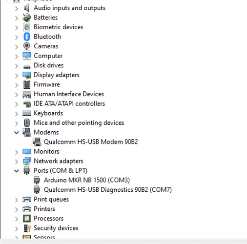

I then tried to start all over again. First, to verify I could reach the MKR I re-installed my "normal" test sketch which sets up an IOT connection. Sketch ran, but it never got any response from the modem, i.e. no AT commands echoed.
Then I installed the passthrough sketch again but this time COM6, "Qualcomm..." never emerged.
Restart of computer did not help.
So has something been screwed up in the SARA chip?
Anyhow I can rectify?
