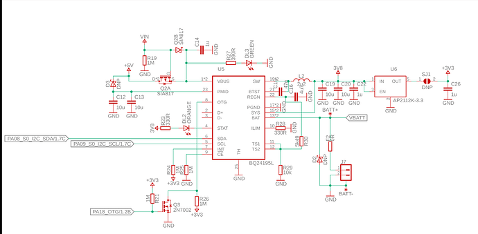

If I connect just the LiPo the µC it doesn't Power Up. Only the power Led lights up slightly.
If I connect the micro usb to the board and its starts normally. Then I connect the Battery, it starts charging. Then I can unplug the usb and the Ardunio runs flawless on battery, for multiple hours.
The Battery is fully charged in this scenario. Is there a way to be able to start up the board only with the Battery?
I tested four different fully charged LiPos and three different MKR1310 Boards. All have the Same Behavior.

But I recognized something different after uploading the Blink example and testing again. The µC actually starts Blinking the led, even though it doesn't light up the power Led.
The Power led (labled ON) only lights up if you connect the usb and strangely enough it stays on after disconnecting the powersource, thats why I thought the µC only runs when the power led is on. Such weird behaviour.

When you say "power led" is that green?
And the charging led is orange?
Looking at the above, I wouldn't expect the green LED to light when running on battery power.

I would thought so, too. But it does, look for yourself.
ChargeLED: Top Left
PowerLED: Top Right
Arduino onboard LED: Bottom Right

Seems like the BQ24195LRGET chip is in a state of boosting the Voltage to 5V on VBUS, also.
Barely lit, almost like a tiny current leaking somehow to the led.
That is odd.
I did think I noticed a change in the brightness of the green LED when you plugged/unplugged USB power. Maybe that's because the led is lit by ~3.7V without USB and 5V with USB. But why it's so much brighter than the preceding video, I have no idea.
