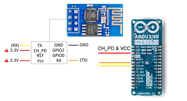

Sorry, I going to try to give more information.
The module ESP8266-01 is connected like that:
When I use a code like that, which is a simple auto-configuration and communication via USB to introduce commands to the ESP8266. Works fine.

What is the source of the 3.3V power? I think it is safe get it from the MKRZERO 3.3V pin. The ESP8266 draws hundreds of mA when its radio is turned on so the 3.3V source must be able to provide this. Check the current rating of the voltage regulator on the MKRZERO board. As I recall, it is high enough.
I would not leave unused pins of the ESP-01 floating. Try connecting them to 3.3V using 10K ohm esistors. But check the ESP-01 specifications. Perhaps some are supposed to be pulled down. I have not used an ESP-01 in years.
gdsports:
The source of the 3.3V is the arduino, and the arduino is powered via USB.
Like I said, when I use a program without the library the board and the ESP8266 works fine. I can give commands via USB and the module ESP reply without problems. I can send and receive messages via wifi whit the module, too.
The problems appear when I try to use the library. Like the program I post before, I only use the library to change the function mode of the ESP to access point and that is enough to soft-brick the Arduino.
If it was what you say and the power source of the ESP wasn’t enough or the floating pins was the problem I think the ESP don’t work in any case. And anyway, that don’t explain why the arduino stops being recognized by the pc.
It could be that library block the serial USB communication?
I think there is a power problem. Perhaps the MKRZERO cannot supply enough current. The ESP may draw little current when idle because its radio is turned off. Changing the mode to AP or STA will cause it to turn its radio on which triggers the problem. Using a separate 3.3V power supply for the ESP should confirm this.
