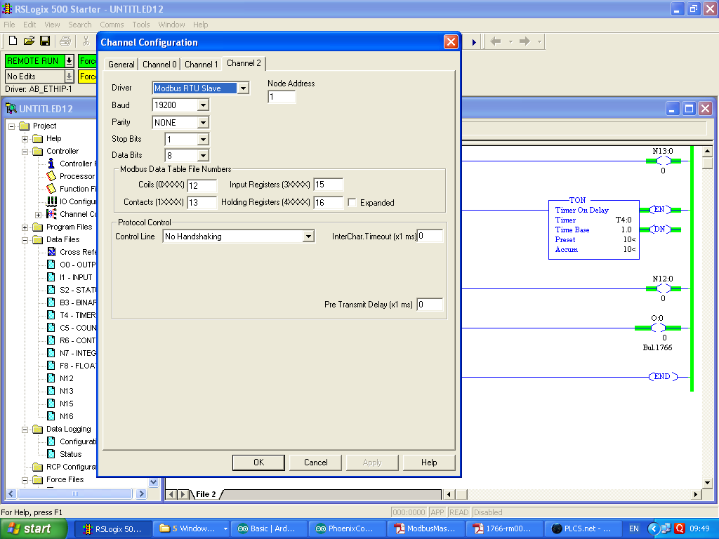

i have set channel-2 of my PLC as a modbus rtu slave
AND THE NODE ADDRESS IS 1

and for that i have written a simple programm in RS LOGIX(programming software for PLC)
i have uploaded the screen shot of that
