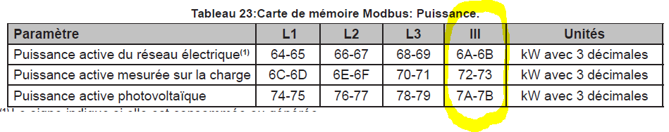

I have some troubles with the data adresses of registers in a controller dynamic power (CDP).
The datasheet and the description of how data is stored in Modbus are in the attachements.
I should read the grid , the load and the photovoltaic powers. I'm looking for the adresses where they are stored.
Could you correct to me these thoughts ?
1-I should add +30001 to the hex adress (6A) mentinonned on the datasheet to get the adress of the
first register requested .
2-The total number of registers requested is 6 .
1-I should add +30001 to the hex adress (6A) mentinonned on the datasheet to get the adress of the first register requested .
That depends on the ModBus library you plan to use. In most Arduino implementations I know you don't have to add the base register address because they use the transfered value directly which is zero based.
I don't know, based on the information you provided yet it's 2 but we are definitely missing a lot of information to answer that question exactly.
