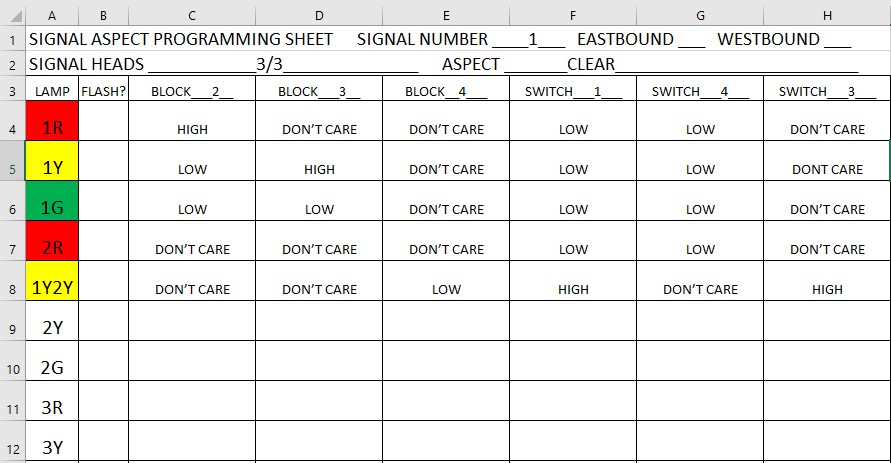

I have a 3 color (R,Y,G) over 3 color (R,Y,G) signal to control a place where there is a switch track. I am controlling what combination of colors to display simply by the states of the six analog inputs and on digital pin used as an input. The inputs will be 0V or +5V based on things like occupied blocks and turnout conditions. So, we're looking at the states of 7 inputs at any time and setting the states of 6 outputs (5V or 0V) to control six LEDs. Quick example.....all low inputs will show a green LED over a red LED.
How do I program for this? Is it a bunch of IF, THEN type loops?

How many different combinations of the 7 inputs are there that require an output ?
jschug1:
Either that or some tables.
There will be 5 combinations or patterns of inputs that require unique outputs.
jschug1:
If there are only 5 possible input patterns then I would convert the 7 inputs into bits in a byte and use switch/case on the resulting byte value to select the row of a 2 dimensional array containing data as to the required state of the LEDs, then use a function to actually set the LEDs to the required states
Thanks. I've gotten a couple of suggestions towards the use of arrays. I'll give it a shot.
Jim

Do NOT start programming now.
First Step:
make a logic table on PAPER, indicating each state of the 7 inputs and the resulting states of each of the 6 LEDs.
When you have this table ready, post it to the forum and some of us will come up with a good proposal.
I have a total of 7 inputs to read that will be 5V or 0V. I have a total of 6 outputs I need for 6 LEDs. I just started at A0 and went from there. I'm open to suggestions.
Jim

Excel sheeet attached. Simple example of conditions for one 3 color over 3 color signal.
Jim
So just a little more clarification......The aspects are green over red, yellow over red, red over red, and yellow over yellow.
Jim
I see only 6 input columns and one output column. Have I interpreted it correctly ?
Sorry, but that makes no sense as there are what looks like 5 rows of possible outputs. How many individual lights are required ?
Lets go with six input columns. There may be a need for a 7th input column some time in the future. I'm sorry for any confusion the chart may bring but again, there are six LEDs, red, yellow, green over red, yellow, green. The output states will be GREEN over RED, YELLOW over RED, RED over RED, and YELLOW over YELLOW. I hope this helps.
excel was fine (even if it was somehow misleading as you are using 6 inputs and 5 Leds now).
next step is to check your logic table against your hardware.
You could use simple if statements
something like this (compiles, but missing your hardware tests)

Its not optimized in any way, just a beginner-write-down as a start.
Will you need only one signal with (5) LEDs or will you need more Signals with the same logic (on other Input pins) in a later stage?
On reflection, switch/case will not work based on the result of reading the inputs because the switch value must be a constant
I will be back later with more ideas
Whatever happened to green over green?
A program to experiment with

NOTES
My test system has active LOW inputs and LEDs. Change the logic to suit requirements
The program uses 4 inputs and 4 LEDs as written but change the array of structs to suit
It is quite possible that I have misunderstood the requirements
I was aiming to make this much simpler but I hope that it is fairly easy to understand. It could be made shorter but I chose to use variables with meaningful names instead of calls to functions inside calls to functions in a couple of places
