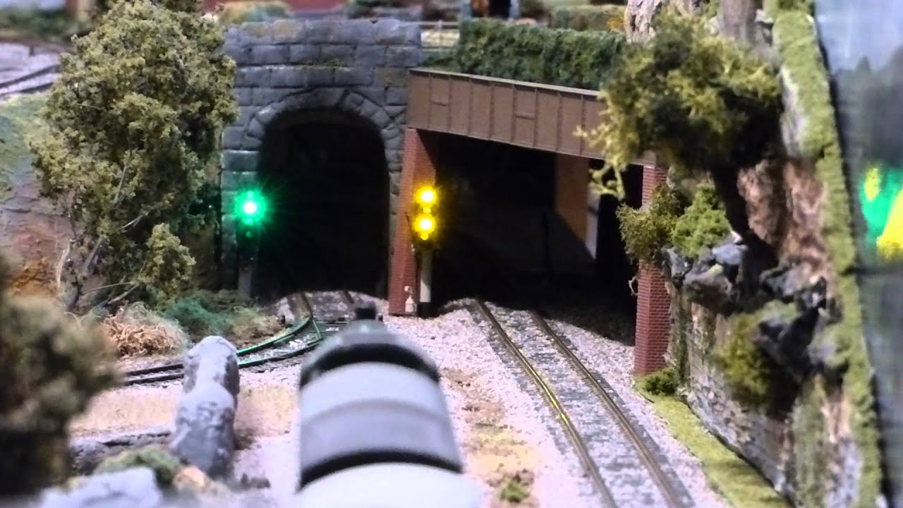

This is the story so far...

Nice video, the signals look good.
Looks like you have an upper track as well, so expect you have plenty more coding /signals to do.

Thanks v much
the bulk of the set-up is done now.
It's just a question of duplicating hardware (signal heads) and software (arduino subroutines).
Next step is to attempt semaphores using servos. Expect I'll be back with more dopey questions.

I about to start the learning curve for utilising a ardiuno to operate signal lights. Can you provive the code that you used to drive your lights as shown on utube. It would give me a great start.

I see that you have four LEDs for each signal post. Do you have a lot of those?
Just to handle those two, you would use 8 digital pins on your Arduino.
Have you heard about Shift Registers (74HC595)? With just one of those, you can set 8 LEDs on and off using only four Arduino pins. Better yet, you can daisy-chain those babies. How many of them? If powered properly, as many as you want, and still controled by only four Arduino pins.
If you are interested, I made a Library that takes care of exactly that.
find it at : https://github.com/j-bellavance/HC595.
Let me know if this helps.
