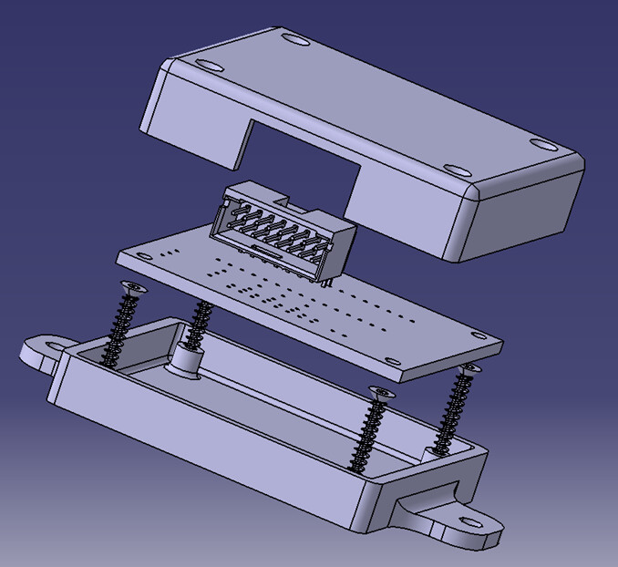

The pictures below show a proposed box I plan to make to house a project I am working on to drive a radiator fan for my car. The box is pretty well sealed with the exception of areas around the connectors. Details of the circuitry are presented in the picture below and the attached link.
The box dimensions are ~ 2.5" x 2.5" x 1". I have multiple modules in my car that are about that size and have lots of electronics in them and have no fans or even heat sinks mounted to the controller. But on the other hand if I take apart my engine management controller there are plenty of heat sinks and a fan does go into the computer box that holds the modules.

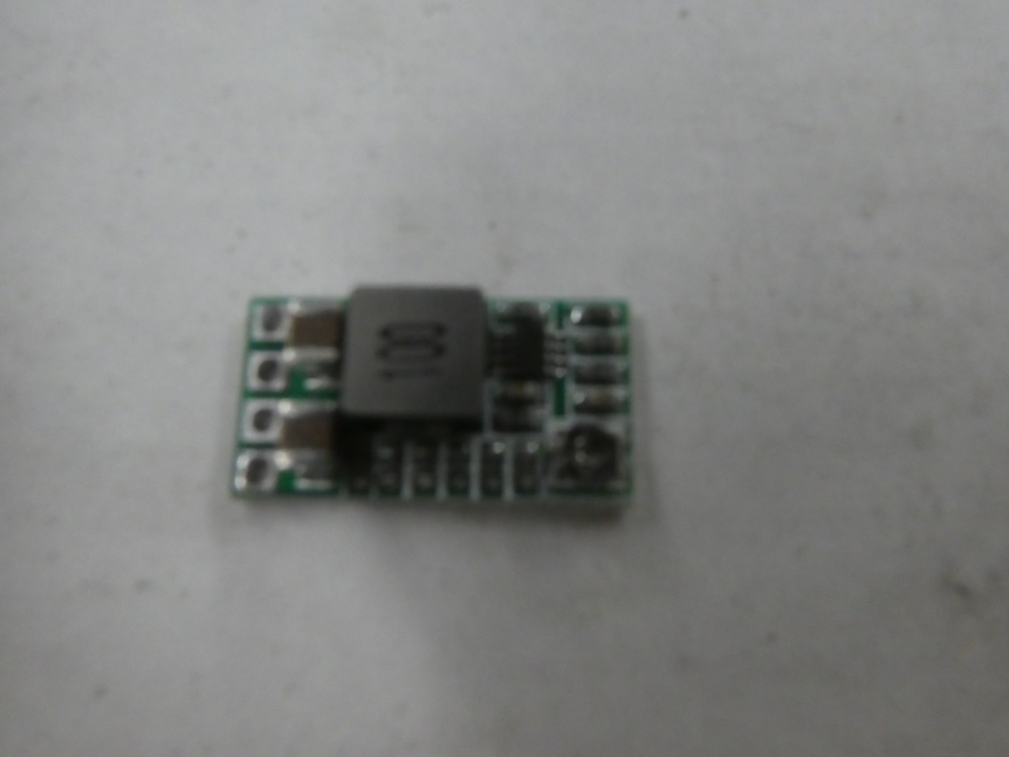

The first picture shows the proposed PCB board that will be going into the box. The second pictures shows a small DC to DC converter that will also go into the box. That converter has no real means of mounting it so I was hoping to just glue it down. But I don't know if that part gets hot and if glue would effect it in any way.

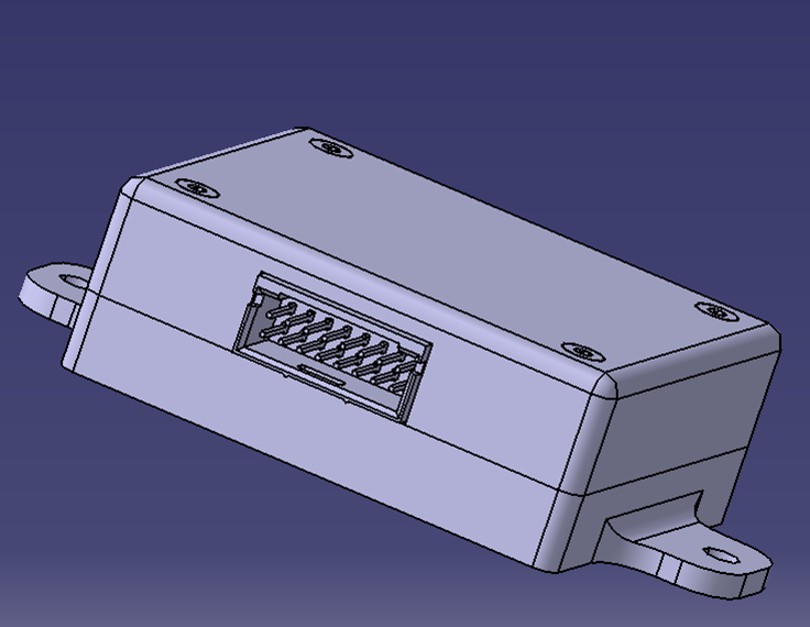

The third and fourth boxes show the the proposed module box.

That's what I'm assuming is checking the box as a whole. I know ~20ma @ 13.8V comes in from the fan so that is about 280mW. And I can add what goes into powering up the Arduino, which I still need to measure. I will have the opportunity to measure that. So if it measures out at 250mW before the buck converter, then the total heat load in the box will be about 530mW.
The interior lights are an excellent analogy. Mercedes had some 10W courtesy lights that they needed to down grade to 5W because they were melting the plastic. They also had some 1.2W bulbs that were fit snugly into ABS plastic sockets that would melt when people tried to use a 2.4W bulb in its place, but in that case the bulb was actually surrounded by the ABS. So I guess in my case. 10 or so components with a total power of 1.2W spread out in a 4 in^3 box should be a piece of cake.
That little buck converter, I still need to find a way to mount. It has no mounting holes, so I would like to just epoxy it in place to the top of the case cover. Is it OK to put epoxy on the back of that circuit board?
