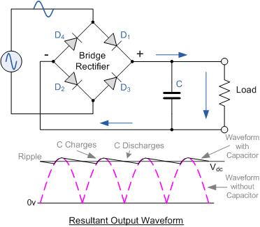

How about a rectifier?
Charges up instantly when the input is higher than the output, but when the input is lower the output decays over a much longer period of time.
I could easily lash up a discrete filter to mimic that.
