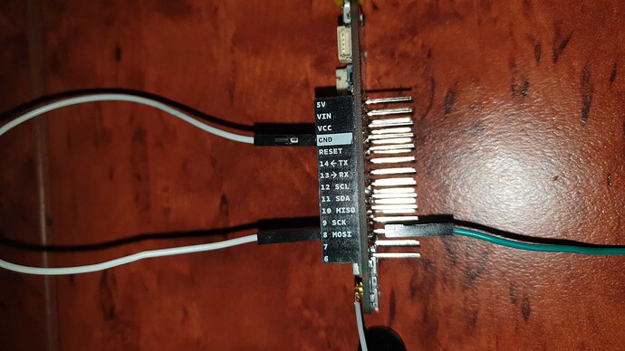

This is looking like a bigger challenge than i thought - i have posted the below photos.
In 'home GND and Board GND connected together' - i have home GND and Board GND connected via PIN 8 and PIN 8 doesn't change when i disconnect home GND. I am assuming PIN 8 doesn't change as in this case all GND are 'common' when connected like this.
In second photo I just have home GND to pin 8 and the sketch continuously triggers until i pull it off. I was thinking i could have sketch say while 'falling' send alarm - but it still triggers alarm while home GND is connected. I think its voltage is varying enough compared to board GND which triggers alarm.
My thoughts - can i make PIN 8 with home GND only connected, always high? then when cut - it falls to zero
Or is there a way to calibrate home GND on PIN 8 to only alarm when voltage is zero...therefore, home GND cut = zero voltage/current.
I guess i am trying to have the sketch look for voltage, voltage present = no alarm, if zero volts on pin 8 = send alarm.
If that seems feasible - can it be done while in deep sleep?

For informed help, you really need to draw a schematic of what you are trying and then display here in your thread. Just writing about what you are doing really confuses me.
Another part of your project would be to use an oscilloscope to study the voltages produced between your grounded wire and the mains ground for your house.
Paul

Will you please read reply #1 again and follow the instructions for posting code; please edit your reply #4 to include code tags </>, and the instructions for posting images. Your photos are useless for helping do what you want, we need the schematic I mentioned.
You are more likely to get help if you provide what we ask for.
Thank you.
The links in the first post didn't work but i think i have now added code as per </> and added photo of basic sketch of the circuit and what i am trying to achieve. Hope that makes more sense now.

I was hoping for something that showed the context, I imagine the wire is more than a few tens of millimetres long. How does the earth from the wire get back to the MKR1500?
TBH, the simplest, and probably most reliable way to do this would be a power supply and a relay so that the relay is operated as long as the wire is not cut. Connect the alarm to the relay contacts.
