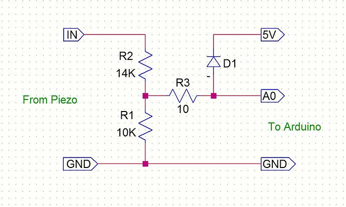

This will work:
Hi, thankyou for the quick response.. i have a very little knowledge about electronics and tried building the circuit.. i cant seem to get my voltage higher than 1v after connecting the resistors.
The circuit will divide the voltage on IN by 2.4
So if you see 1V out, the voltage between GND and IN must be 2.4V
Are you applying 2.4V on IN

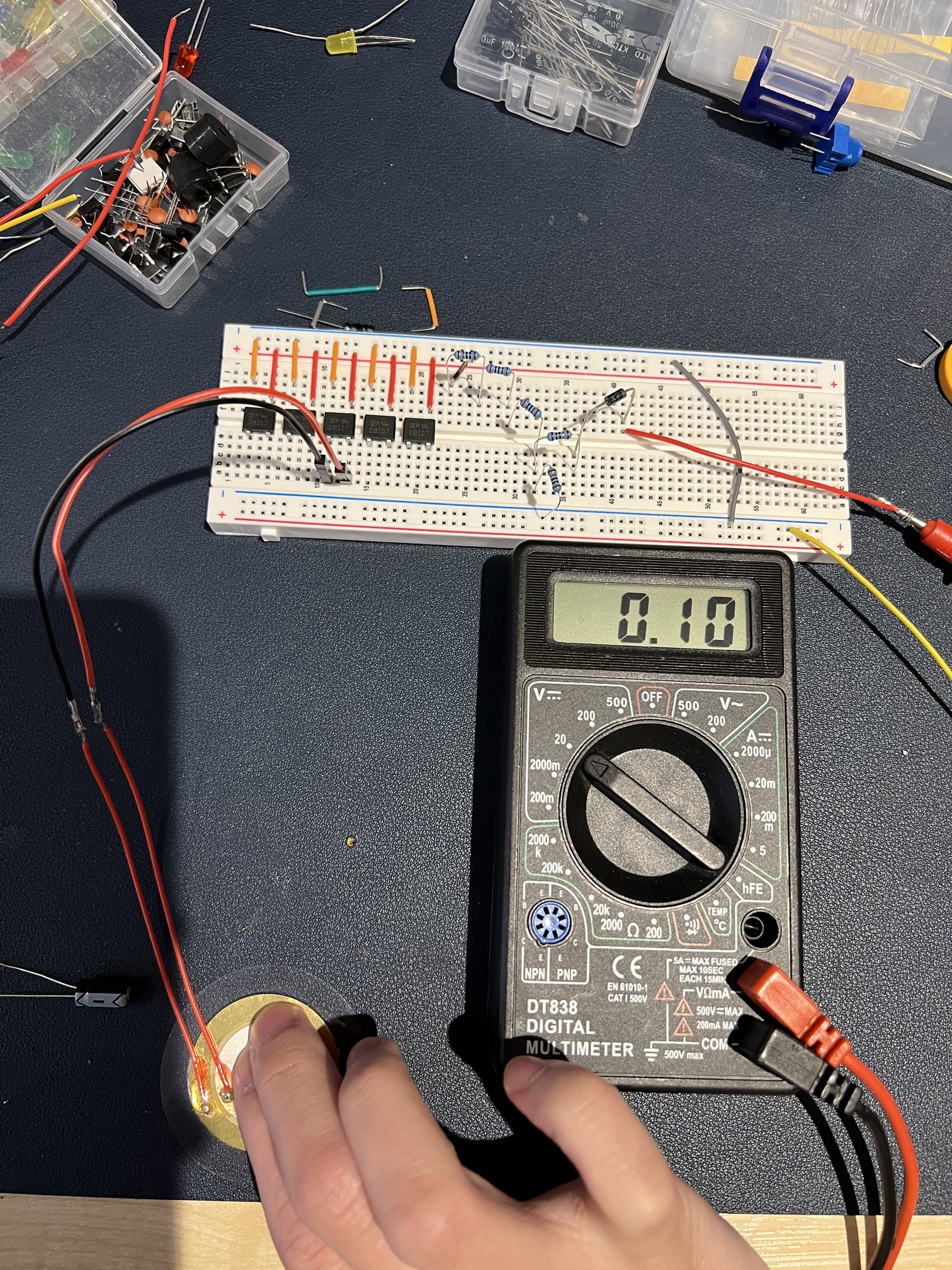

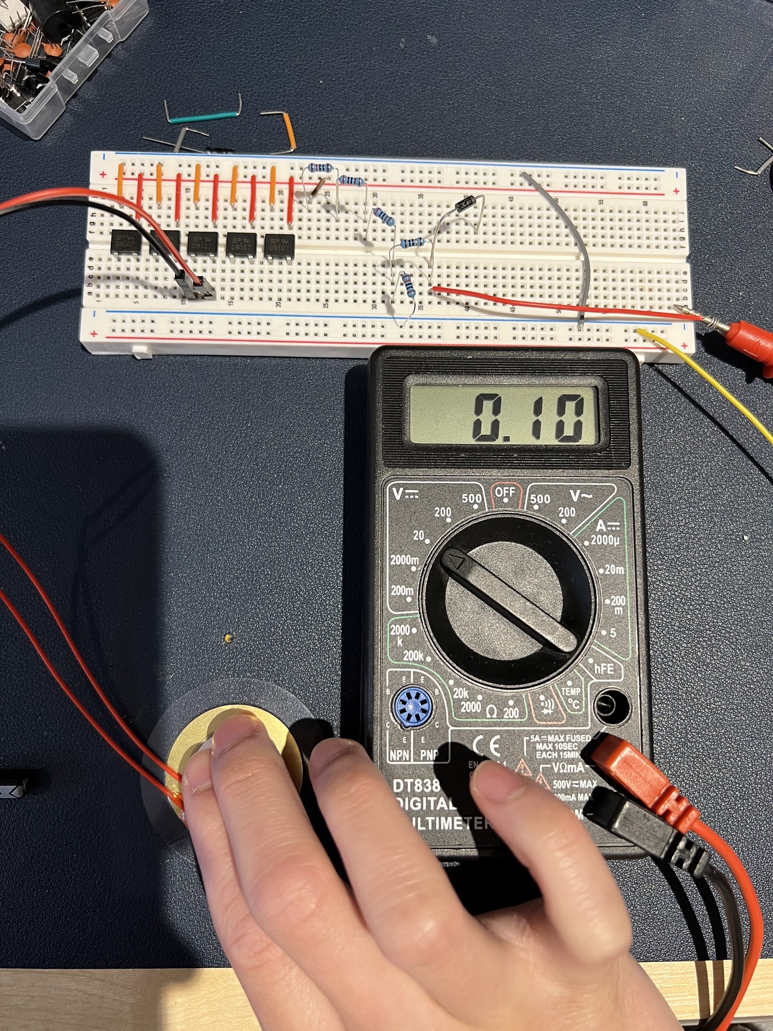

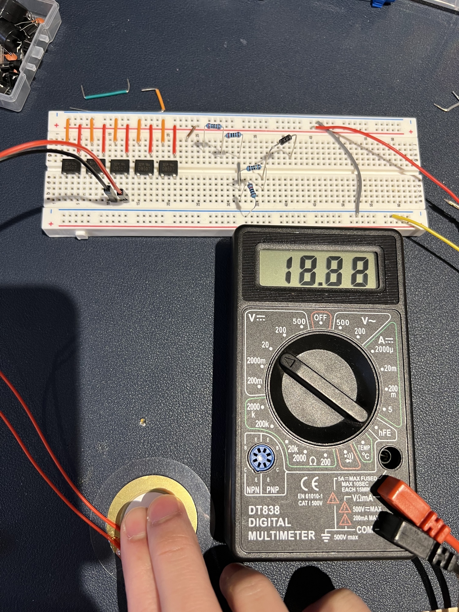

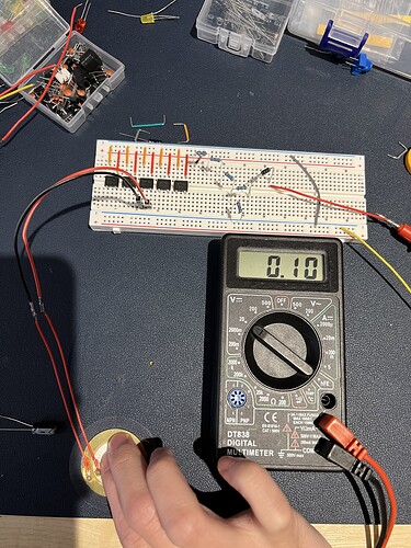

I’ll upload a photo of my set up measuring voltage at various points.
1st one is my voltage produce by piezo without the resistors connected. Varies between 0-15V
Then here’s the set up with the resistors
Please do correct me if it needs some more improvements. Thank you!!

The resistors are loading the transducer.
Repalce the 10K with a 500K and the 14K with 750K
