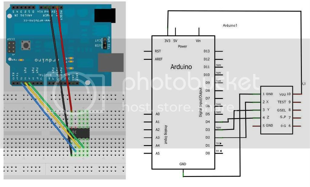

I've been tinkering with an accelerometer (http://www.robotsimple.com/MMA7341L_3_Axis_Accelerometer_3_11g?keyword=MMA7341L) with an Arduino Uno and was hoping I could get some answers to a few questions.
I've adapted one of the tutorials found here to add a Z axis and tweaked it a little.
   The circuit:
    * X output of accelerometer to digital pin 2
    * Y output of accelerometer to digital pin 3
    * Z output of accelerometer to digital pin 4
    * +V of accelerometer to +3.3V pin
    * GND of accelerometer to ground
   Adapted slightly from this tutorial
   http://www.arduino.cc/en/Tutorial/Memsic2125

Everything is “working” but I don't quite understand the numbers. When it's just sitting at rest the readings from the serial port are hovering around 0, but whenever I reach to touch the Arduino, the numbers jump to around -300 without my actually touching the Arduino. I'm still a novice with this thing, but recently when doing a tutorial on buttons I learned that buttons had to be debounced. Is that same thing happening here? If so, I could use some guidance on that, I can't find many tutorials on accelerometers.
For a project I'm working on (more about it below if you're interested) I would like the accelerometer readings to be a little more predictable. Right now I can set the arduino down in place or one certain position (propped up against a wall or on a book etc...) and the readings are never quite the same two times in a row. Is the accelerometer taking too fine of readings? And if that's the case is there a way to calibrate it so it takes more coarse readings?

Can you post your schematic as well? Hard to say what software will do not knowing how hardware is hooked up.

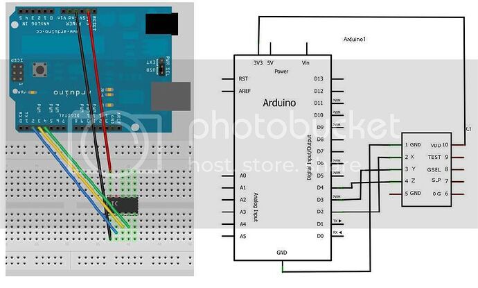

Here's how I've wired it.
Can you make the picture a little larger so we can read it?
You may want to look into using a digital accelerometer instead, as some of them have built in algorithms for orientation detection and tap detection which could cut down the amount of code you need to write.
Thanks for the heads up. I resized the pic again. I noticed it earlier but for some reason photobucket didn't like it when I resized it earlier, I had to change the name of the photo. The less code I have to write the better.
I would start by connecting the second GND pin on the accelerometer.
Also, that sketch won't work for this accelerometer. The accelerometer you are using is analog and your sketch is written for an accelerometer that has a PWM output.
Need to do this too:
"The sleep pin, Sleep, is internally pulled low, which puts the board into low-power sleep mode by default. You must drive this pin high to use the board. This can be accomplished with a microcontroller I/O line if you want selective control of sleep mode, or you can make a solder bridge across the SMT jumper pads labeled “ON” on the silkscreen side of the board to connect the sleep pin to VDD and enable the board by default."
Yes indeed, need to read inputs on the analog lines:
"The accelerometer X, Y, and Z outputs are three separate analog voltages centered at VDD/2. Positive accelerations along an axis increase that axis’s output voltage above VDD/2 and negative accelerations decrease the output voltage below VDD/2. The outputs will always be within the range of 0 to VDD."
