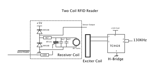

After some additional thinking, you might be able to use a 4 quadrant logic level triac. You would have to have the triac connected to ground and the speaker between the triac and the audio output.
However I have no experience with triac's in this type of application.
Triacs are meant to conduct AC power and normally not low level signals. But you do have an AC signal. The "4 quadrant" type of Triac allows you to turn it on with a positive signal to the gate even though the input signal is / can be negative with respect to the common connection.
I have use triacs in a low voltage situation in this project:- RFID Sequencer
This is the schematic of how it is used:-
Basic reader
The triac is a BT131 and is in parallel with the receiver coil. I used it to short out the coil for readers I was not interested in, to prevent the coils acting like passive radiators and making one token look like it was on many readers.
