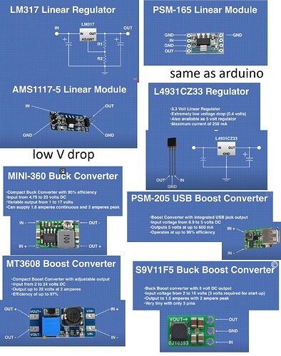

After some research I found a voltage regulator is great for filtering power from various supplies before circuit components. I'm assuming because the added capacitors store the extra energy to level out any dips?
so then can I just add 2 to my circuit below to handle any problems? or is the problem between the esp signal and the driver?
I think the buck boost converter would be best.
Are there any current issues to look out for?
You need to filter the power to the MCU, not the motor.
The motor power supply should be chosen to handle at least twice the maximum expected motor current (e.g. for a brushed DC motor, the start/stall current).
From that fuzzy picture the bottom converter is shorted.
The voltage regulater in my circuit diagram shows a regulator between 12V plug and MCU. Not sure if you saw that
So I just need to check current supply?
I imagine that you think so, but no one could be sure what a white square labeled "V Converter" might actually be.
A hand drawn schematic with standard component designations and intelligible labels would be much more useful.
