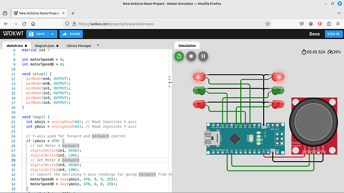

Motor Project Not Working
I am doing an Arduino Motor Project, however I unfortunately have got an issue with the movement of the DC Motors. The system uses a 2x DC Motors, Arduino Uno, H-Bridge and a Joystick. Currently the movement and action are as so;
Joystick Left - Right Motor OFF Left ON
Joystick Right - Right Motor ON Left OFF
Joystick Down - Right Motor ON Left OFF
Joystick Up - Right Motor OFF Left ON
The actions of the Down and Up are not acting as expected. The action should be for both Down and Up, both Left and Right Motors ON. I expect the issue is with the code, specifically the X Mapping. I would appreciate it if someone could take a look. Thanks in advance.
NOTE: I have used 2x Potentiometers as there isn't a Joystick available in Tinkercad.

Are you really using a smoke alarm battery for the motors? Those batteries have difficulty supplying the current required by motors. You need a power supply that will gracefuly handle the motor stall current. Stall current should be listed on the motor data sheet or data plate.
The ancient and ineffecient L293 is only good for 600mA and will drop 2V to over 4V of motor power in its output stage and dissipate the power as waste heat. Many vendors incuding Polou have modern efficient MOSFET output drivers. Choose a driver that will work with your motor rated votage and stall current.
Please read the how get the most from the forum posts to see how to properly post code and some good information on asking questions.
Please go back and fix your originial post.
The semi-colon ( ; ) at the end of the last command will not let your code compile.
[edit]
Your "A" motor starts out not enabled and your "B" motor starts out full gas.
At "mid point" the motors are being commanded to move forward, but neither is enabled.

These lines in two places seem odd
    motorSpeedA = motorSpeedA - xMapped;
    motorSpeedB = motorSpeedB + xMapped;
It looks like acceleration not absolute speed. I see the clamping logic that follows.
And is it true your motors only spin one way ever? If these lines are all and when the motors speed is controlled, I don't see what controls the direction.
  analogWrite(enA, motorSpeedA); // Send PWM signal to motor A
  analogWrite(enB, motorSpeedB);  // Send PWM signal to motor B

I will guess your battery is not sufficient to push fan motors. Are the fans 9vdc? If they are, and you connect the battery directly to the two fans, do the fans turn? The connections with the L293D look right. Your code "works" (again, it starts with full-reverse and the enable is disabled depending on the direction you push the stick, and more fun things). Get the power supply issue figured out and I think you will see the fans move.
Files for WOKWI.COM - the LEDs represent FWD, ENBL, REV

diagram.json
  "version": 1,
  "author": "Anonymous maker",
  "editor": "wokwi",
  "parts": [
    { "type": "wokwi-arduino-nano", "id": "nano", "top": -4.8, "left": -19.7, "attrs": {} },
      "type": "wokwi-led",
      "id": "led1",
      "top": -97.2,
      "left": 112.2,
      "rotate": 90,
      "attrs": { "color": "green" }
      "id": "led2",
      "top": -68.4,
      "left": 112.2,
      "rotate": 90,
      "attrs": { "color": "red" }
      "id": "led3",
      "top": -126,
      "left": 112.2,
      "rotate": 90,
      "id": "led4",
      "top": -97.2,
      "left": -46.6,
      "rotate": 270,
      "attrs": { "color": "green", "flip": "1" }
      "id": "led5",
      "top": -68.4,
      "left": -46.6,
      "rotate": 270,
      "attrs": { "color": "red", "flip": "1" }
      "id": "led6",
      "top": -126,
      "left": -46.6,
      "rotate": 270,
    { "type": "wokwi-analog-joystick", "id": "joystick1", "top": -58.2, "left": 159, "attrs": {} }
  "connections": [
    [ "nano:GND.2", "led2:C", "black", [ "v0" ] ],
    [ "nano:GND.2", "led1:C", "black", [ "v0" ] ],
    [ "nano:GND.2", "led3:C", "black", [ "v0" ] ],
    [ "nano:GND.2", "led6:C", "black", [ "v0" ] ],
    [ "nano:GND.2", "led4:C", "black", [ "v0" ] ],
    [ "nano:GND.2", "led5:C", "black", [ "v0" ] ],
    [ "nano:9", "led4:A", "green", [ "v0" ] ],
    [ "nano:4", "led6:A", "green", [ "v-86.4", "h-86.4" ] ],
    [ "nano:5", "led5:A", "green", [ "v-28.8", "h-76.8" ] ],
    [ "nano:10", "led1:A", "green", [ "v-57.6", "h96" ] ],
    [ "nano:7", "led2:A", "green", [ "v0" ] ],
    [ "nano:6", "led3:A", "green", [ "v0" ] ],
    [ "joystick1:VCC", "nano:5V", "red", [ "v9.6", "h-76.8" ] ],
    [ "joystick1:GND", "nano:GND.1", "black", [ "v19.2", "h-105.6" ] ],
    [ "nano:A0", "joystick1:HORZ", "green", [ "v38.4", "h182.4" ] ],
    [ "nano:A1", "joystick1:VERT", "green", [ "v28.8", "h153.6" ] ]
  "dependencies": {}

Both Fans are 5V DC and I have some 12V DC Fans and the outcome is the same. Joystick Up = Nothing, Joystick Right = 1 Fan, Joystick Left = 1 Fan, Joystick Right = 1 Fan, Joystick Down = 1 Fan.
I have tried to increase the Supply Voltage from 9V to 12V and then 18V, but the outcome is the same.
I was considering using a L293D, but the L298N was the only one available. As this is only a project I wasn't too bothered about its efficiency, however I do need both Motors to be running together.
Use more descriptive words than "1."
In post 16, I describe the simulation showing both motors full-on forward, with joystick movement causing the Enable pin to go low. If you put two HIGHs on a motor, that is one way to stop it, and joystick movement replacing a HIGH with a LOW, sometimes giving the Enable a LOW. I suspect wiring and logic are not matched.
