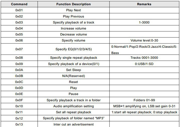

I like to know if any of you can help me in a sketch to show the music that's playing on 16x2 LCD screen.

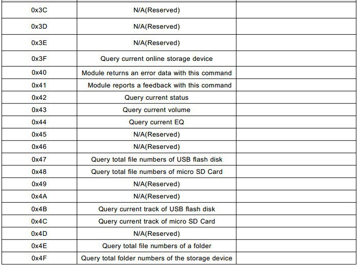

I want to use the Arduino to read via TX RX, the music that is playing.
Because on the device there are query commands.
I believe that with the Arduino I send a command via TX for module, and read the answer via RX and show it on the LCD display.
Yes, if you connect the device to the Arduino correctly.
Which one(s) give the name of the track?
I think it is: 0x4c
0X4C

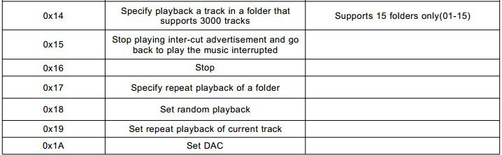

I tried to send the value 0x01 (play next) for the Mp3 player for serial, but nothing happened.
How do I send this value?

Looks to me that you need to send 10 bytes for a command, not just 1.
The command byte is just byte 4 of the 10 bytes needed.
