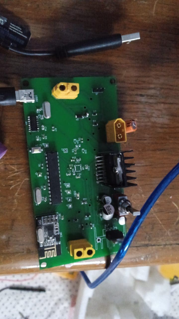

i have combined mpu6050 , arduino uno,nrf24 and l298n for a self balancing bot.
I have done the following when the sensor values were freezing :
Changed the pull up resistor(on SCL and SDA line) value to 2.2k and also 10k ( it was originally 4.7k)
added decoupling capacitor to nrf24, 7805 voltage regulator and battery terminals and ceramic caps to motor terminals
added timeout to code in arduino ide in setup( for mpu6050)
{#if I2CDEV_IMPLEMENTATION == I2CDEV_ARDUINO_WIRE
        Wire.begin();
        Wire.setClock(400000); // 400kHz I2C clock. Comment this line if having compilation difficulties
        Wire.setWireTimeout(3000, true); //timeout value in uSec
    #elif I2CDEV_IMPLEMENTATION == I2CDEV_BUILTIN_FASTWIRE
        Fastwire::setup(400, true);
    #endif}
Still the mpu freezes. kindly find the pcb layout attached,
In the end I removed the mpu ic from the board and tried using the module available in market by connecting to the jumper wires to the pcb board, still the same problem.
The mpu fives erratic value as soon as the motors are connected , without the motors connected the serial monitor gives correct values
If i limit the pid output to -90,+90, it works but motor moves slowly, increasing it to -255,+255 freezes the mpu as soon as the motor starts
I tried connecting the uno, l298n and mpu module available in market through jumper wire using the same code. It works perfectly. Is there a problem using all these on the same PCB board.
How could I resolve this, still a beginner in this. Please help
Hi, @mayankgangwani
What is your power supply?
Where are you getting the 3V3 supply?
If it is from the CH340G, pin 4 is not a 3V3 supply, it is a reference pin that has a capacitor connected to it.
It cannot supply anywhere near the current needed for the NRF and the MPU.
Do you have a DMM?
If so measure the 3V3 line while your project is running.
Did you breadboard your project and get it running before going to PCB?
my power supply is 18650 li-ion battery 3.7v, 1200mah(3cells)
the 3.3v power is from CH340, It works fine if i do not connect the motors, i have monitored through serial monitor for hours the mpu as well as nrf works fine.(i have read the angles and also the nrf inspection code which is working fine) . I have also used V3 pin for powering nrf in another project which works fine
I have measured the 3.3v through dmm, that line is fine .
i have used readily available modules before going to PCB, and it all worked perfectly
Then it can be component layout.
You have the MPU and the 298 close to each other and motor current is possibly causing noise on the MPU connections.
It would have been better to place the MPU on the other side of the controller IC and a ground plane added like around the voltage regulator.
plugging out mpu ic and connecting the mpu6050 module through jumper wire is also showing the same problem. Is changing the PCB design is the only solution, is there any way that I can be sure that the pcb design is the only problem ?
Would this design work ?? The J9 is for mpu6050 module. Rest everything is the same
Just a thought out of right field.
You are using 4K7 for the I2C pullups, as you are using 3V3 on the pullups but then I2C bussing to a 328 which is 5V.
Might be a problem there.
You could possibly use lower resistance pullups because of the 3V3 supply.

Apart from the motor you have the NRF popping out RF.
I2C only has weak pull ups for the simple reason that it is pulling an input pin high.
As for the rest, the output from the NRF may be too low to trigger the gate and decreasing the pullup value will make it worse, by tying the line harder to +5V.
Test remedy, increase the pullup resistor, or simply remove it, given that if this is the I2C variant of the NRF, , the board may already have weak pull_ups.
Lower the I2C speed, to prevent the data being scrambled.
However from the photo of the board, I can only see the NRF24L01 which is an SPI device.
I thought you needed a SPI to I2C board to make this I2C?
If not, can you point me to the NRF device which has I2C as an output?
Both schematic and PCB layouts need to be looked at carefully but there are some redundant components at first glance C26, not needed.
As you said, pin 4 is a power supply line for the output stages of the CH340G and should not be used as a power line to other devices. It is most likely getting its 3V3 from the 5V supply, however I have no idea why it is being used for the NRF device, which has a VCC of 5V
Weak pullups mean a high circuit impedance when the I2C wires are HIGH.
Try lower to decrease the circuit impedance and reduce the influence of noise.
Try reading the original Phillips I2C specification.
Decreasing the pullup ties the line harder against the supply Voltage and causes slewing of the signal especially at higher data rates.
I have no idea where you get the idea it has anything to do with circuit impedance, other than in an adverse way, by decreasing the resistor value.
update: I am using the following setup to make changes easily and check , arduino , nrf24L01 , mpu6050, l298n motor driver, 25ga motor 200rpm 12v , jumper wires
so now the pull up resisitor on mpu 6050 module is 2.2k to 3.3v, it still freezes(it takes more time to freeze than in pcb but it does) , could you please suggest what should be my next step , reducing clock speed makes the mpu6050 not functional

update : i have attatched capacitors like this to reduce electric noise , and it worked like a charm in the latest setup ( everything connected through jumpers)
this is according to the pololu article : Pololu - 9. Dealing with Motor Noise.
then i connected the mpu6050 module to my pcb through jumper wires, as i plugged out the MPU IC on pcb to check.
Now here the output marked in green worked perfectly without any problem, but as soon as connected the motor to output marked in red (output 1 and 2) , it again disrupted the functioning . According to me this problem is not due to I2C lines but electrical noise since adding caps solved it in earlier setup. So i commented the nrf lines in code and then tried it still hanged in the red marked output. I then doubled down the caps at the motor
and also added 220uf 40v caps to 7805 regulator even though there are 47uF caps already in place, and also 100uF cap to battery
still the problem is same in pcb, Is it due to ground plane being close to that output?? or something else, I would be grateful if anybody could help

The PCB layout is a complete mess anyhow, but you do need to check the junction of D9 and D10 are at Gnd. From what I can make out this line is just dangling with a string of components which are supposed to be at Gnd.
Putting a load of capacitors across your motor, instead of a single capacitor is not really going to help. Think of it as placing a short circuit at higher frequencies, the frequency is determined by the value of the capacitor.
Decoupling capacitors on IC's, are supposed to be connected as close to the pins of the IC as possible, otherwise they won't be as effective.
You appear to think that jamming a load of capacitors around the place is some sort of solution.
The 220uF capacitors around the 7805 are not needed as 47uF should suffice.
Large capacitors are usually added to smooth out any ripple you have on the PSU lines. In this case you are running this off a DC battery source(No ripple).
